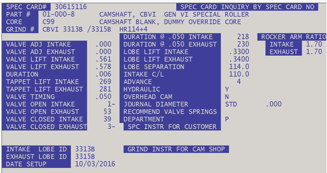

I have 31's on it now with no problems, but since I have 225k miles on it I'm giving it, its 100,000 mile Fix up. In this case the engine also was done. Before the Brodix Aluminum Heads and the Bigger cam (See Below) and the Fast EFI, it was rated at 550 TQ, and 450 Hp. The header are 2.25 Primary and 3.5 long tube in design to promote no exhaust exit issues if I add a Twin Screw SC to it, so there is plenty of room to grow if my pocket will allow it The Compression Ratio is 8.7:1. I tried a Procharger, but I really need a lot of low end grunt, and the engine will probably make all its power under 6000 rpm's.
