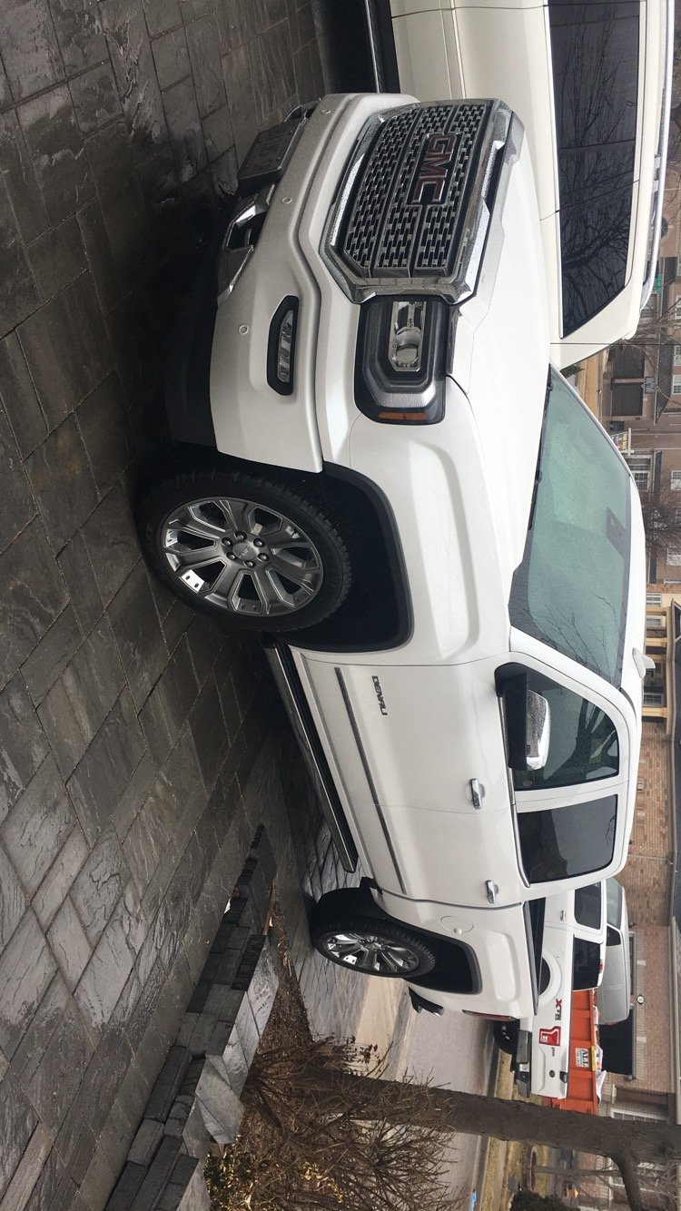

Hello,
I just bought a 2018 Sierra Denali ultimate and I want to change the reverse light bulbs and license plate light bulbs and cargo light bulbs to white ones and add a leg tailgate bar with brake turn signals and reverse.
does anybody have any recommendations?AD27F0C0-4301-47FB-9D50-8965BD5F874C.thumb.jpeg.4afd4dc766597ce647707c4b832041cb.jpeg
