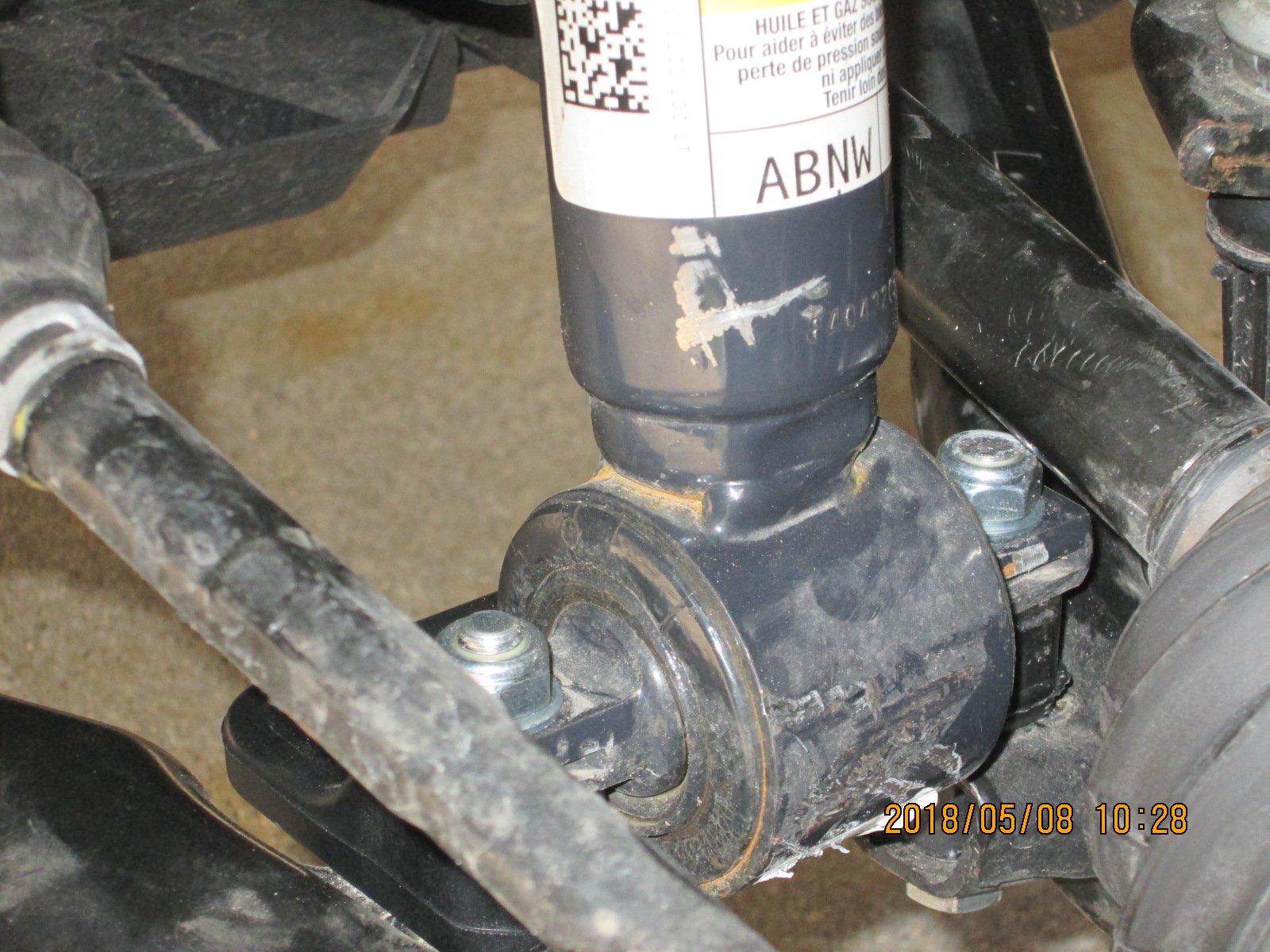

I had the dealership install a Rough Country "2 leveling kit on our new 2018 Chevy Silverado LTZ while they had it in for a vibration issue.
When I realized the install was NOT done per the instructions I was p!ssed.
Is it possible to install those leveling blocks below the shock mounts without taking all the joints apart in that area.
LOOKS LIKE THEY PRYED UP ON THE SHOCKS AND GOT IT IN THERE.
Pry marks all over the control arms and shocks, no indication of any of the original hardware being loosened or removed (which means they didn't disconnect the electric steering).
The new mounting bolts are all inserted from the bottom up with two of the studs GROUND DOWN to the top of the nut. Paint scraped off the shocks like they put channel locks on them.
They know I am aware of this and want to talk about it.
Not sure what to do.
Is it possible for them to install it that way or is it the cobb job it looks like?
Please help!

If you paid the dealer to install it they should be able to do it without modifying or damaging any parts or hardware.  I would tell them to replace whatever they damaged, and install the lower bolts correctly.  Often techs working in shops are paid a flat rate.  This means they get the same amount of pay if it takes them 10 minutes, or 2 hours to install your stuff.  If they can find a shortcut they can make more money.  Clearly that is what happened here.  I would at least ask that they replace the bolts, put them in correctly, and touch up the paint on the other parts to prevent future rust issues.  I would also talk to them about some credit or a free oil change for the fact that you had to come back due to their tech being in too much of a hurry.  Be sure to take photos of all the issues so you can reference them later if needed.

They didn't do it per the instructions from what I can see. Rough Country claims this will void their warranty.
There shouldn't be pry marks all over the shocks and A-arms with paint scrapped off.
