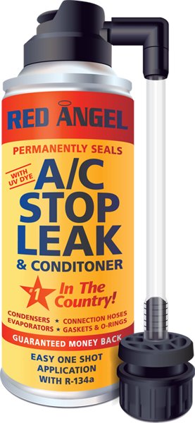

Also, what are your thoughts on a can of R134a with sealant to stop the leak?  My gut tells me that I shouldn't even be considering it as a possibility, but I'd really like to hear the opinions of folks who are well-versed in this kind of thing.
I used to have a nice car that leaked A/C coolant. It leaked very slowly, so I had to add a bottle of 134A Freon every couple of months. I would always keep my eye out for deals on Freon. I found a pallet of them on clearance at Walmart for $1 each. I bought 350 bottles. Finally, after many years of adding Freon, I added a bottle of sealant, and it permanently fixed the problem. And for all of you green thumb guys that say I am the "devil" for leaking Freon into the environment - check this out:
I used a can of stop leak on my 2010. It plugged the orifice tune within weeks and I had to replace the orifice and accumulator. It is still leaking about 5-6 oz, per year But thats OK because its all 12A. I ditched 134a when I did the repair.
