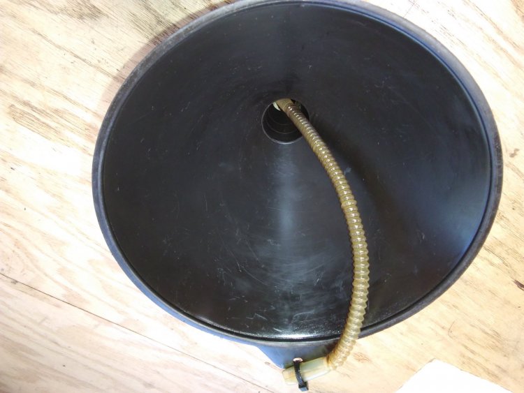

Or make one like I did.
One flexible straw and a zip tie.
Just make sure the end of the straw hangs below the bottom of the funnel spout to vent the air.
I use this for all fluid transfers.
Not dealing with the upside down pics.
You get the idea.
