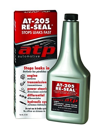

If your front end is anything like mine, replacing the front differential output seals is not worth the trouble, unless they are gushing oil out. You have to take a lot more apart than you would think.
   Try this instead:
