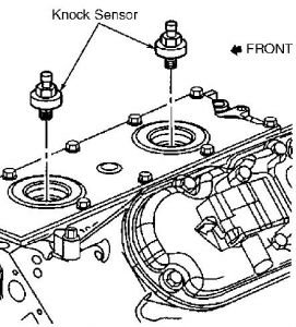

Your knock sensors are sitting in a pool of water. Very common issue. It corrodes and shorts out the connector. Been there. Is it your front or rear senor that is throwing a code?

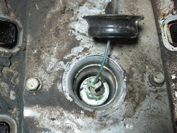

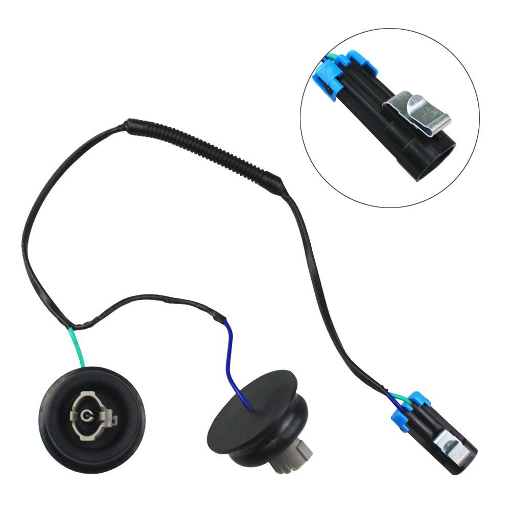

Your knock sensors are fine, but you need to fix the connector, where it attaches to the top of the sensor. The book (and the dealer) says that you need to pull the intake manifold, and replace the sensors and harness, and then use silicon sealer on the sensor boots. You don't need to do that. You can reach under the front of your intake manifold, and remove a large piece of foam, which is locking the moisture in. It was designed that way, to allow moisture in from a hose or pressure washer, but wont let it back out even with evaporation (you can guess why). Anyway, you can touch the front sensor with your hand, so hopefully that is the problem sensor. Buy a new sensor harness, and splice it in by re-routing the harness through the front of the manifold rather than the rear.
If your sensors are shot, and have to be changed, don't pull the manifold. Just thread the sensors into the threaded holes in the front of your cylinder heads, and hook up the new wiring harness. DO NOT buy cheap knock off sensors, they don't work. Get the good OEM ones. I have tried both. You need the OEMs for sure.

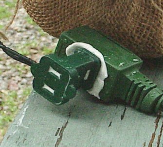

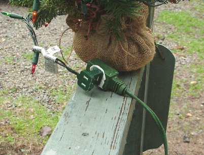

Dialectic grease does not conduct electricity, so it can be used used to keep water out. See pic:
