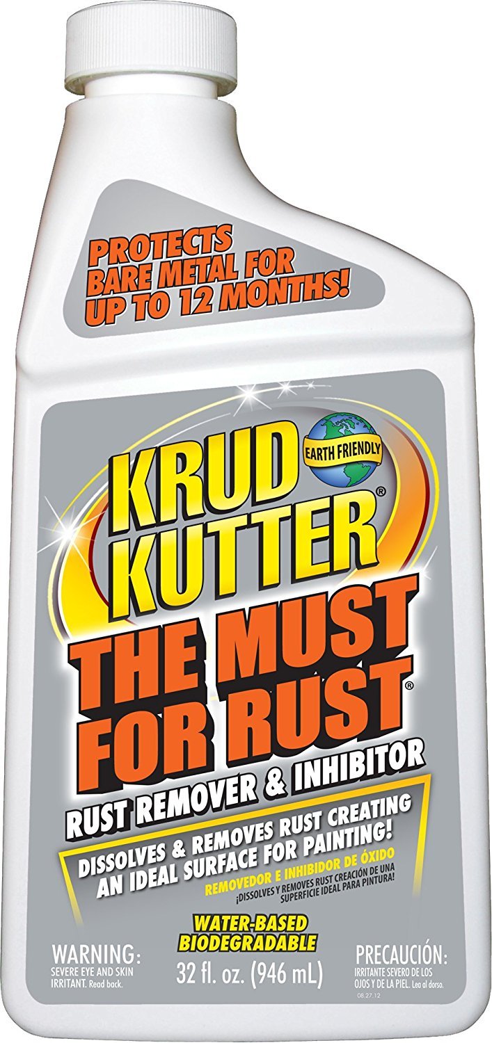

If you want to stop the rust and protect the lines, spray them with this stuff every year on your birthday.

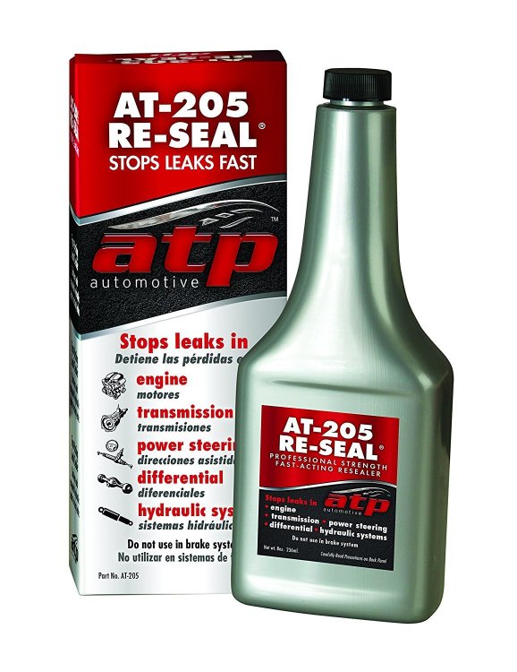

If the tip of the plug keeps getting oily and fouled, then you either have: Worn valve guide seals, or worn piston rings, scored cylinder wall, etc.
There is also a TSB about the PCV valves on that rig. The old PCV valve is superseded by a new design that limits the amount of oil that gets drawn into you cylinders.
If your valve guide seals are bad, you could try ATP-205. That may resolve the issue.

so this ATP-205 is safe to use?  i have always been told these types of products are not good for the engine.
You are correct that most "stop leaks" are not good for your vehicle. Radiator stop leak, engine stop leak, tire stop leak, etc. None of those are very good to use however, ATP-205 in not the same an normal engine stop leak products.
Normal engine stop leak products cause rubber to expand, which could close up any gaps, but it can also pop the seal out and now you have a HUGE leak.
ATP-205 works differently. When seals get old, they become hard, rigid, shrink and crack. The reason this happens is because there is a special chemical in the rubber that basically evaporates over time. That special chemical is what keeps the rubber soft and pliable. Well, ATP-205 is 100% "special chemical". So it soaks into hardened rubber seals and returns them to their original soft condition. It will not replace missing rubber, and it will not cause the rubber to expand, so that means it doesn't work every time. If your seal is completely shot, it wont help at all on that particular seal, but it will benefit the other seals in the engine.
I would never use regular engine stop leak products, but I have used ATP-205 in several engines, one transmission, and a front axle. I have had very good results. If your valve guide seals are not working very well, this product may restore them and eliminate the oil burning. It certainly wont hurt anything.
There are a million Youtube videos about this product. I have seen most of them, and people say good things about it.
The manufacturer website has videos on it, but the Youtube videos are more credible to some people.
