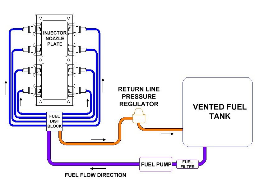

Yep, like he said, it could be a voltage issue. That would cause the pump to run slower, and that would effect pressure. I'm not sure what would cause the voltage to drop, but it is theoretically possible. Maybe a bad ground?  If your pump is not working properly, then it will not build pressure. On the other side of the scale, you need "back pressure" to build fuel pressure. Unlike carburetor fueled engines, fuel injected engines have a pressure regulated fuel return line. If your return line is not restricted, you will never build pressure. It would be like trying to build pressure in a balloon that has holes in it. Doesn't matter how much air you push into the balloon, you will never inflate it. Could be supply, could be restriction. Ya just gotta test everything and figure out which one is the problem. Either issue is plausible.
