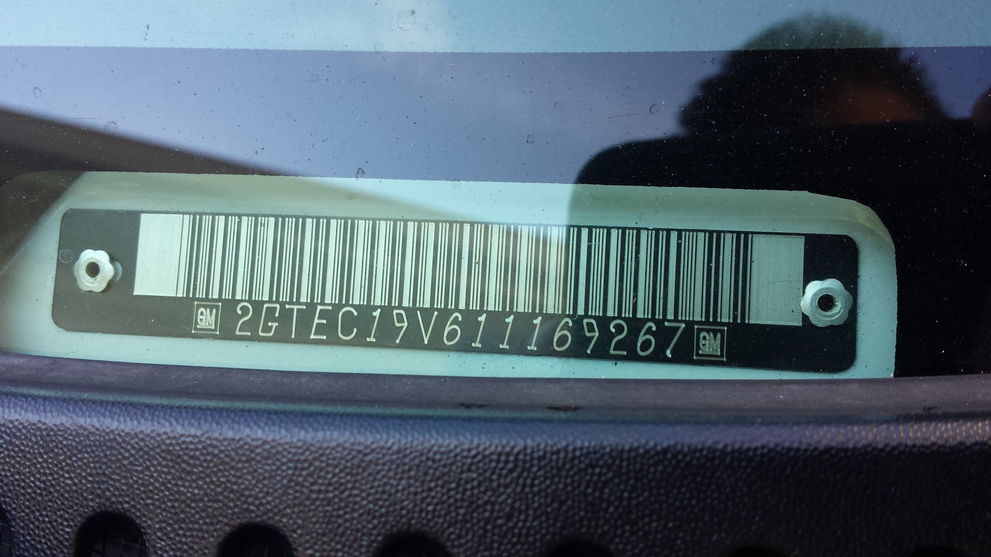

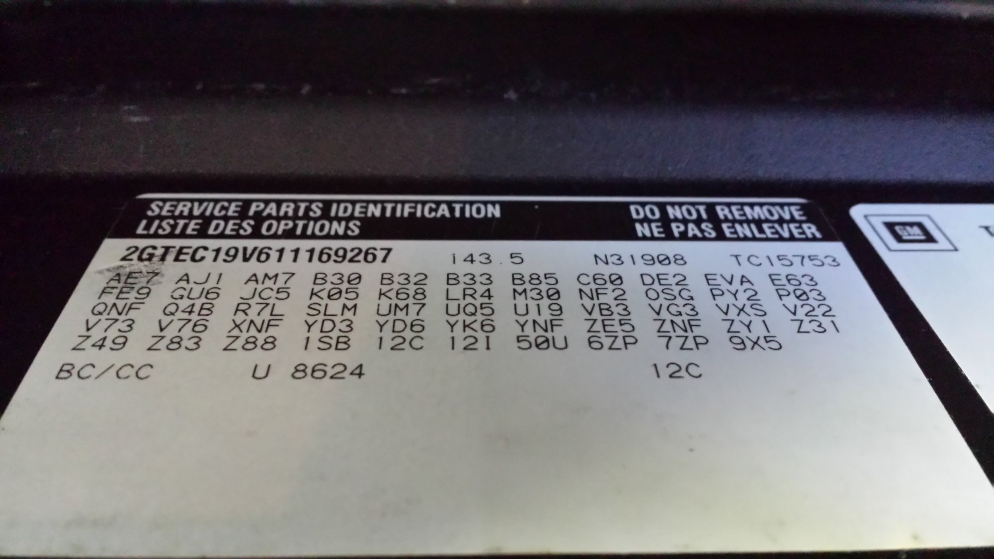

Hey guys I need your help I have a 2001 GMC Sierra SL 4.8L V8 and I went to the dealer to get a key cut to my VIN for the key code I get home and try it on the ignition and doors and it doesn't work any reason why here is my VIN and RPO Code from my glove box if any one can reply or send me a PM of what is my key code to confirm with the dealer? Thank-You

If they used your VIN then it should be correct. Maybe check with another Dealer and see if the code for your VIN matches. Could just get the new key cut from your original key and let it go. Depends on what you are trying to accomplish. Good luck.
correct redvett the key cut to the vin was not the same cuts I am still going to havent had time to get a key cut from a locks-smith to confirm if it was cut wrong or the the ignition was changed
Guys I have an update went to a automotive locksmith and he confirmed that my vin and key code are right for my vin and he looked at my current key and can tell its a totally different key code which is why the key cut to vin doesnt work at all, my question how is this possible if even the airbag on and off switch works with my current key and the spare tire lock on the bumper so bottom line is someone went to great lengths to change all locks to match my current GMC key so if i want to go to what my vin says i have to change everything or just let it go like one guy said in the thread and just get a new key coded copied to what i have now, ive owned this since April 2003 so looks like prior to me owning it some monkey business went on and now key code to vin isnt so, when the time comes where I cant turn the ignition lock cylinder not sure what to do best would be to go back key code i think would make sense any thoughts and input from you guys is helpful
