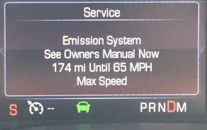

New to me truck with 25K miles just flashed this code.  With P204B Error Code
Stopped by dealer and they said "Regen needed"
I have had the truck for two months, plenty of Def fluid and was planning on taking a trip this weekend.
Thanks for your advise.
Was thinking about it more. My commute is 20-40 minutes of highway driving. That’s what they want for a regen. If the previous owner did a lot of short trips and no highway... it really just might need a road trip.
Idling isn’t good enough for regen. It needs to be working a bit to regen.
I drive this truck, EVERY DAY, and a hundred miles per day.  I am governed down to 55mph now!  haha!
There has got to be something wrong with the truck!  I made an appointment monday morning to drop truck off and get it worked on.

Attached is a pic of the Def fluid tank located above the spare tire.  Inside is a sensor, that went bad.  Had to replace the sensor.
DTC P204B
Reductant Pressure Sensor Performance
