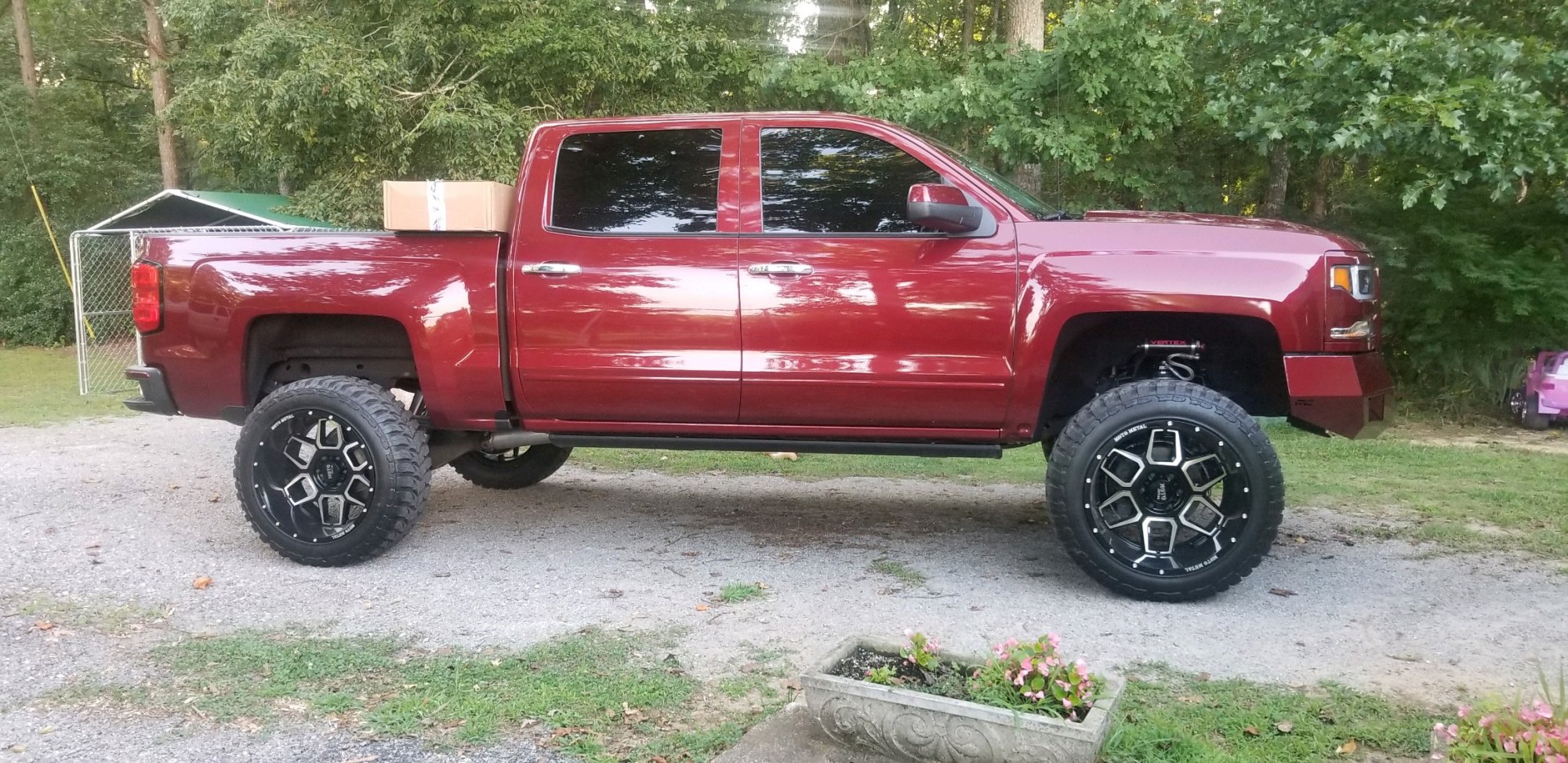

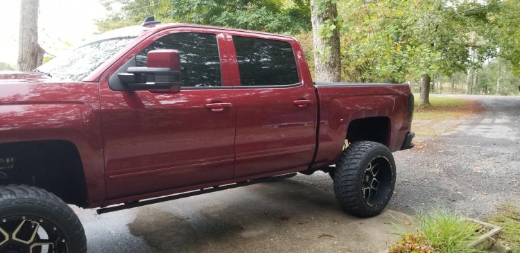

On 10/23/2019 at 7:13 PM, Kmbz71 said:
I got a quick question. I recently bought a 2016 Silverado 1500 z71. Its got all the bells and whistles but after doing some digging i found out the previous owner had 4.56 gears installed. I bought this truck from a Chevrolet dealership and i think they didnt know about the gear swap. Im speculating but do you think the dealership would have wiped out the aftermarket tune for the gear swap and reset it back to default? The truck will get up and go but there are times that if i really hammer on it especially when i go to make a pass the rpms get so high so quick the engine will cut off. Its happened more than id like to admit. The truck has 35's on 22's and drives like a dream otherwise but sometimes i wanna let it sing! Do you think i need to take it to a tune shop? Is this normal with 4.56's? First photo is without tows second photo with tows.
I had a 17 5.3 6spd with 4.56 gears. 6" lift, 20's with 35's. Traded it for a Callaway SC560
Mine used to cut off in between 1-2 shifts using a handheld tuner.
Once I had a professional tune done to the ECM and TCM, the shifting was perfect and never cut out again.
I do not pretend to know more than I think I know, but I think if the speed calibration in the tune does not pair indentically ECM to TCM it might be causing the shift cutout at very high RPM. But I will leave that there for the more experienced tuners to chime in.
Did you ever get this fixed?   I just did 4.56 gear swap and mine is doing the exact same thing!
