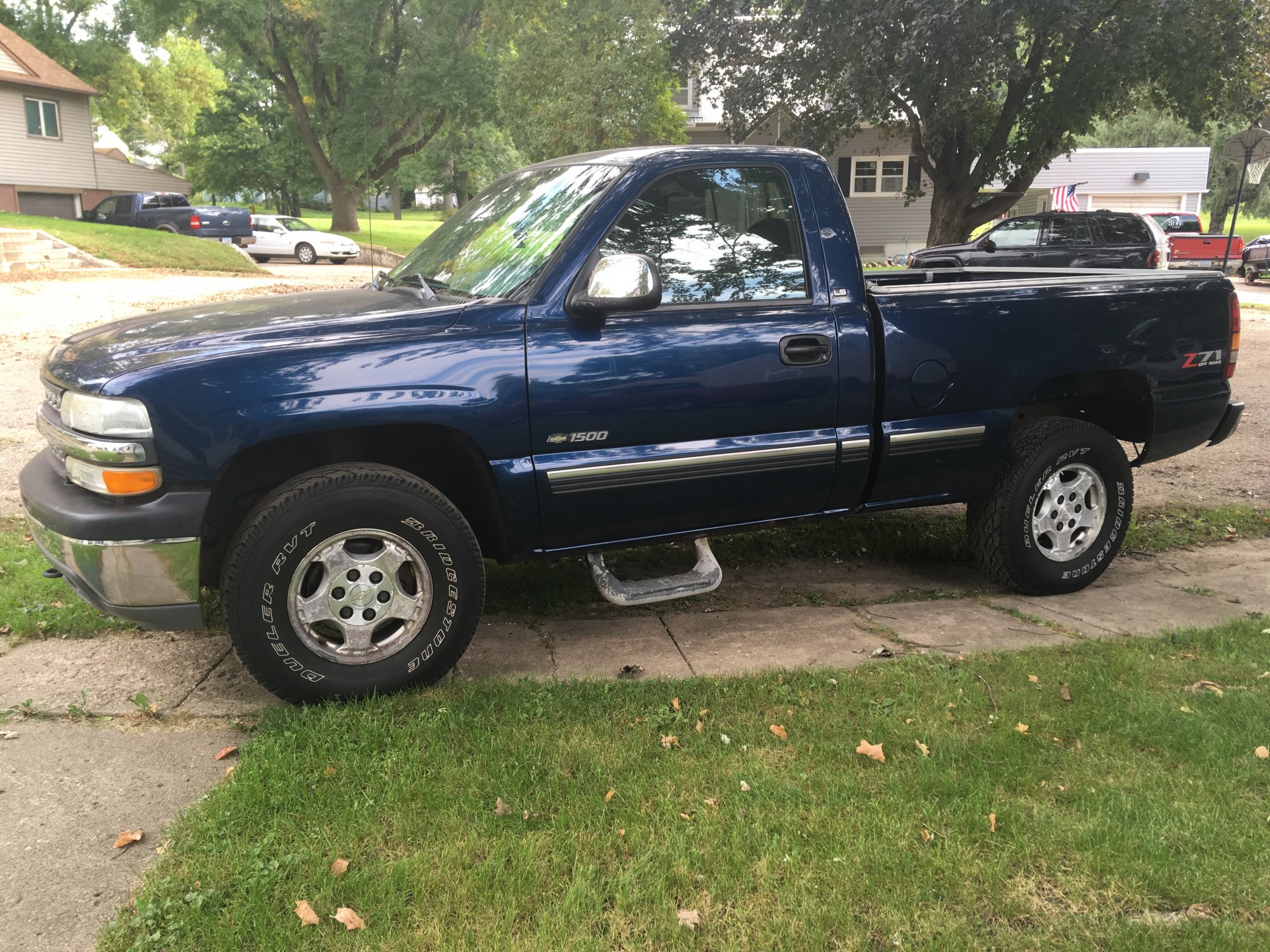

I recently got a deal on a 2001 Silverado z71 LS.  I want to tow a 2 horse bumper pull trailer with it with one horse. So could be 4-5 thousand pounds total. I don't doubt that it's capable but I live in Iowa and wind speeds can get pretty high. I am willing to invest in a weight distribution hitch and trailer brakes. Do you think I would be comfortable and safe? Or do you think that the short wheel base will kill it?

you are right that a short wheelbase limits.   I think most trailer guidelines I’ve seen is don’t tow over 80% the max tow

Engine?  Axle ratio?
Check the owners manual for towing ratings based on those two factors.
With a WDH and trailer brakes I think you should be fine with your RCSB towing a 2 horse trailer, ONLY because a 2 horse trailer is relatively short. If you were talking a 28-30 foot TT that's a whole other story, you probably would be getting into the realm of the tag wagging the dog scenario.
