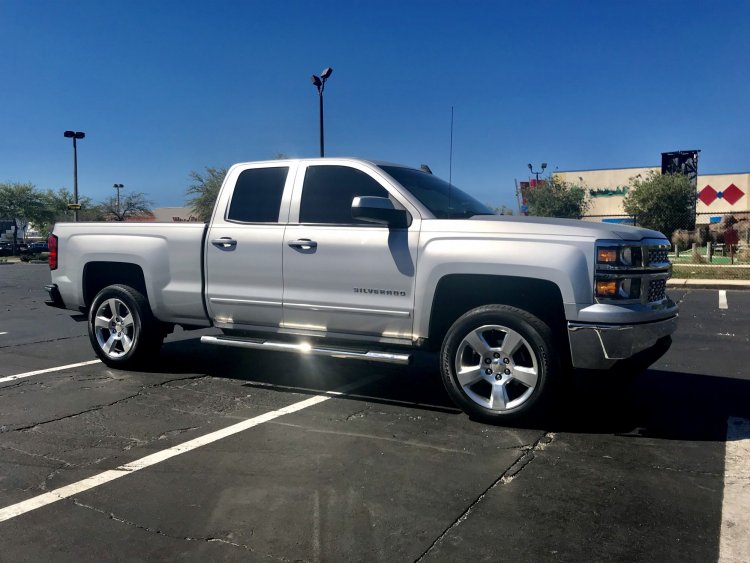

i have a 2015 Silverado 1500 on a RC 2.5 Front level on stock 20’s. Just hitting 35 miles and will be ditching the stock Continental tires here soon.
I want to go with a little bigger (wider and taller) tire without dealing with rubbing or losing too much MPG. Any recommendations are appreciated!!
I love done so much reading on here but somehow ended up more confused ? it seems like the 33x12.5 will rub according to a lot of people in various forums, I honestly don’t know much about how to zip tie and fix the rubbing issue. Just curious of what tires won’t rub at all
Easiest way to is go to and measure your truck to see what you can fit. Go full lock both ways on steering wheel and measure the gaps on both sides of the tires at full lock. That’ll let you know exactly what your specific truck can fit before you start to rub. If you can’t get someone to hold the wheel, use a seatbelt.
