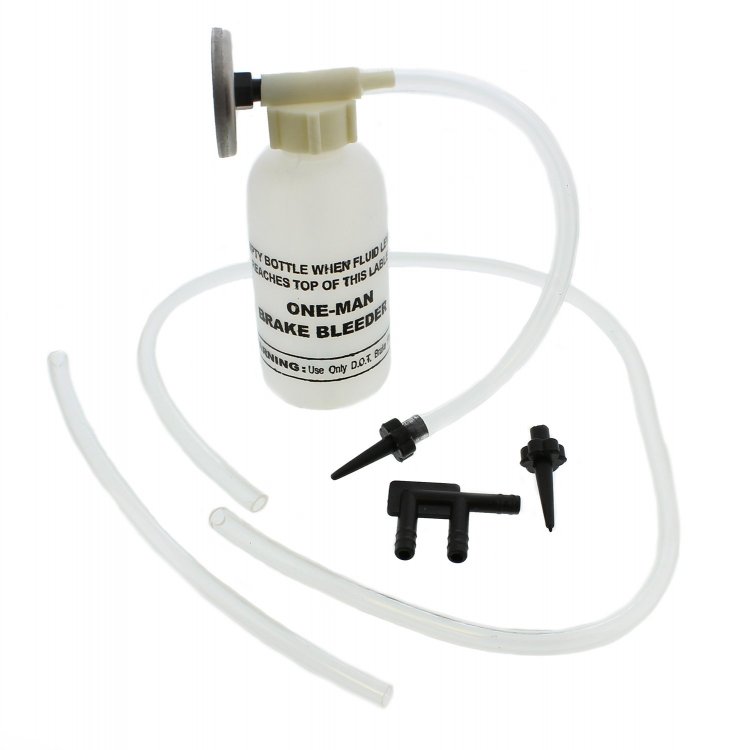

I would close the rear bleeders, remove the front bleeders, fill the reservoir, and then go have a cup of coffee. Come back after a while and see if the fluid reservoir level dropped at all. If not, I would try using a bleeder kit like this:
