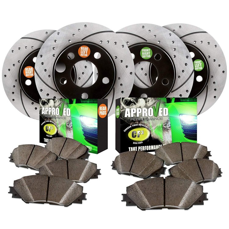

Have you thought about aftermarket, replacing rotor and pads with something better? You would think you could get just pads from EBC, Willwood, Baer, etc.
You would have to search around a little, but they probably make this kit for your rig. The drilled & slotted rotors stay very cool, and the carbon fiber ceramic hybrid pads grip the rotor extremely well. I have put these brakes on several rigs, including my own. I always replace the brake fluid at the same time just for good measure. You will have VERY responsive brakes, that can outperform OEM parts. I really like these a lot.
https://www.amazon.com/Approved-Performance-Silverado-Avalanche-Escalade/dp/B00KLOCVZ2/ref=sr_1_2?ie=UTF8&qid=1544652656&sr=8-2&keywords=Approved+Performance+2014+Chevrolet+Silverado
i'm not sure how slotted/drilled rotors would hold up to the mountains of salt that gets put on the roads in Western New York.
The rotors are perfect on my truck with 45k miles on them so I just wanted pads only. If I had the money and was hauling stuff I would definitely upgrade the calipers and everything with some Wilwood big brake kits.
