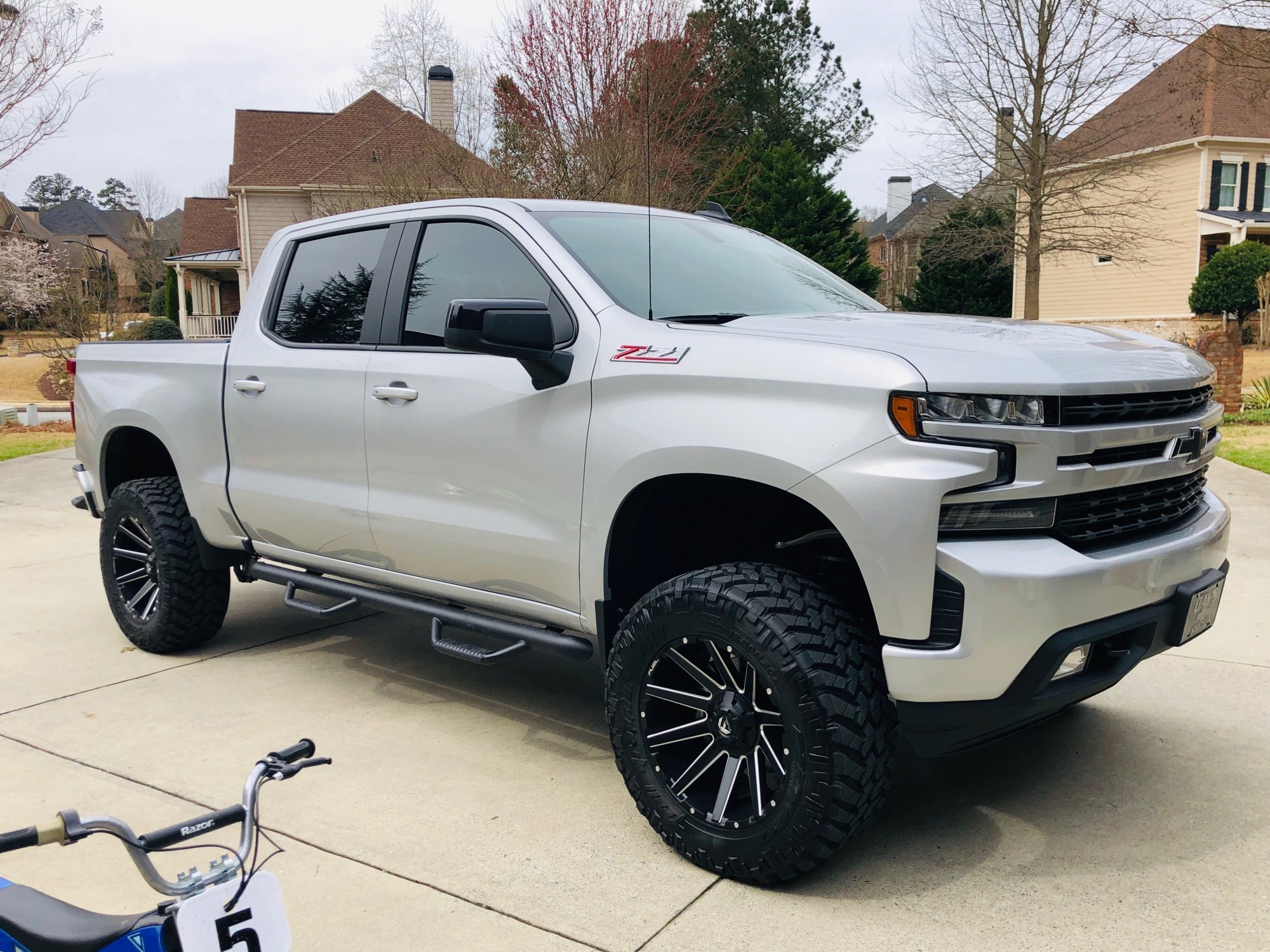

35s only have 2 inches to avoid rubbing with a 6" lift.   I wouldn't do 35s with a 3.5"
If you don’t want to go too high with a lift, maybe try a leveling kit first. You can still throw bigger tires on there. I ran a 2.5” Rough Country leveling kit without the back spacer on my ‘14 Z71 and was actually able to run BFG KO2s on there in 285/65/20. Those measured to about 34.5”, and were mounted on the stock 20s. I had rub in full lock, but it wasn’t much. I didnt bother to zip tie or cut, just kind of lived with it. Was very happy with the stance and ride. Not sure if you’d have that same clearance on the ‘19s, as I also have a 6” lift running 35s and like BillyDee posted above, clearance is pretty tight. I actually have a tiny bit of rub at full lock with this truck, too.
