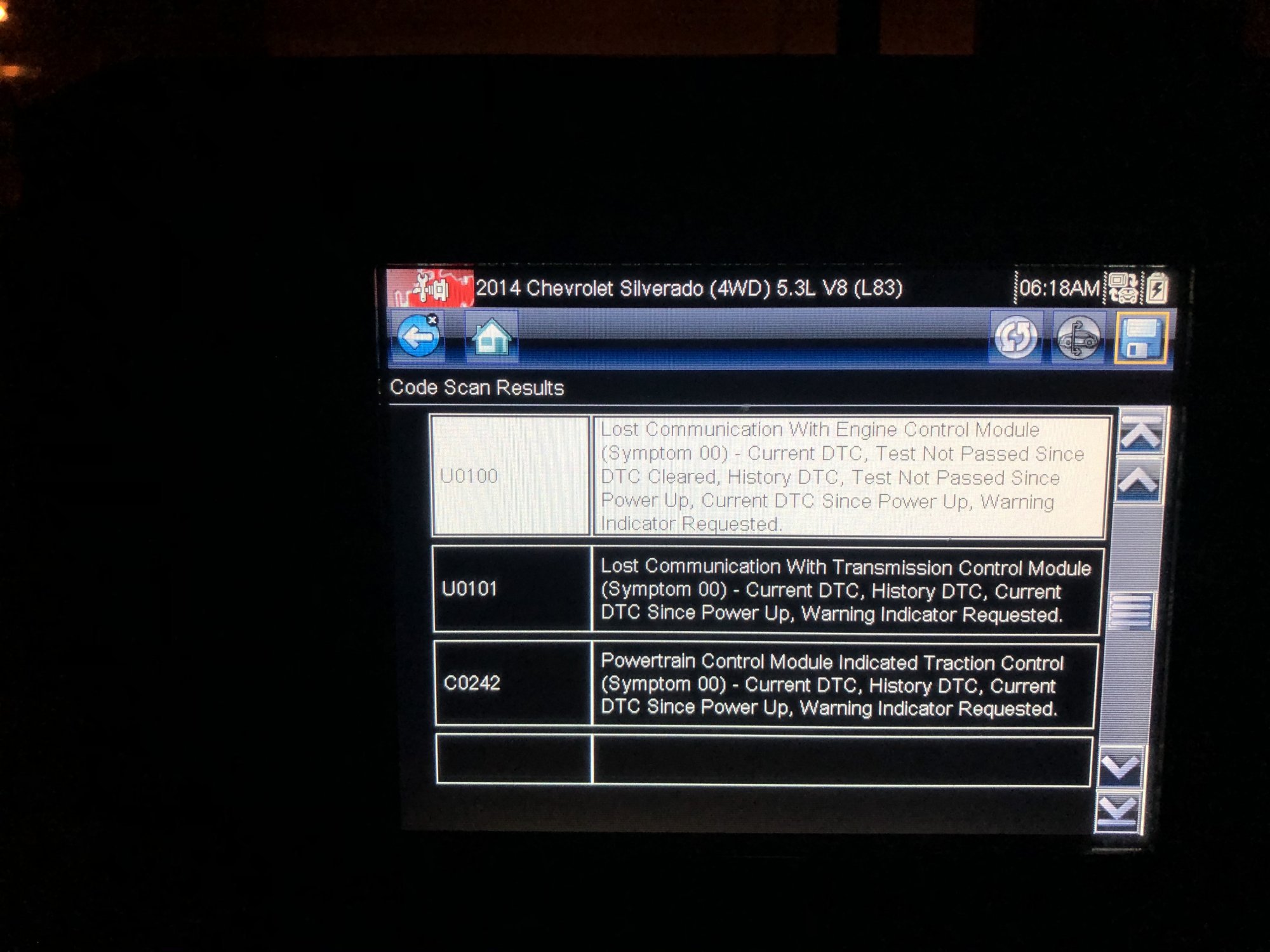

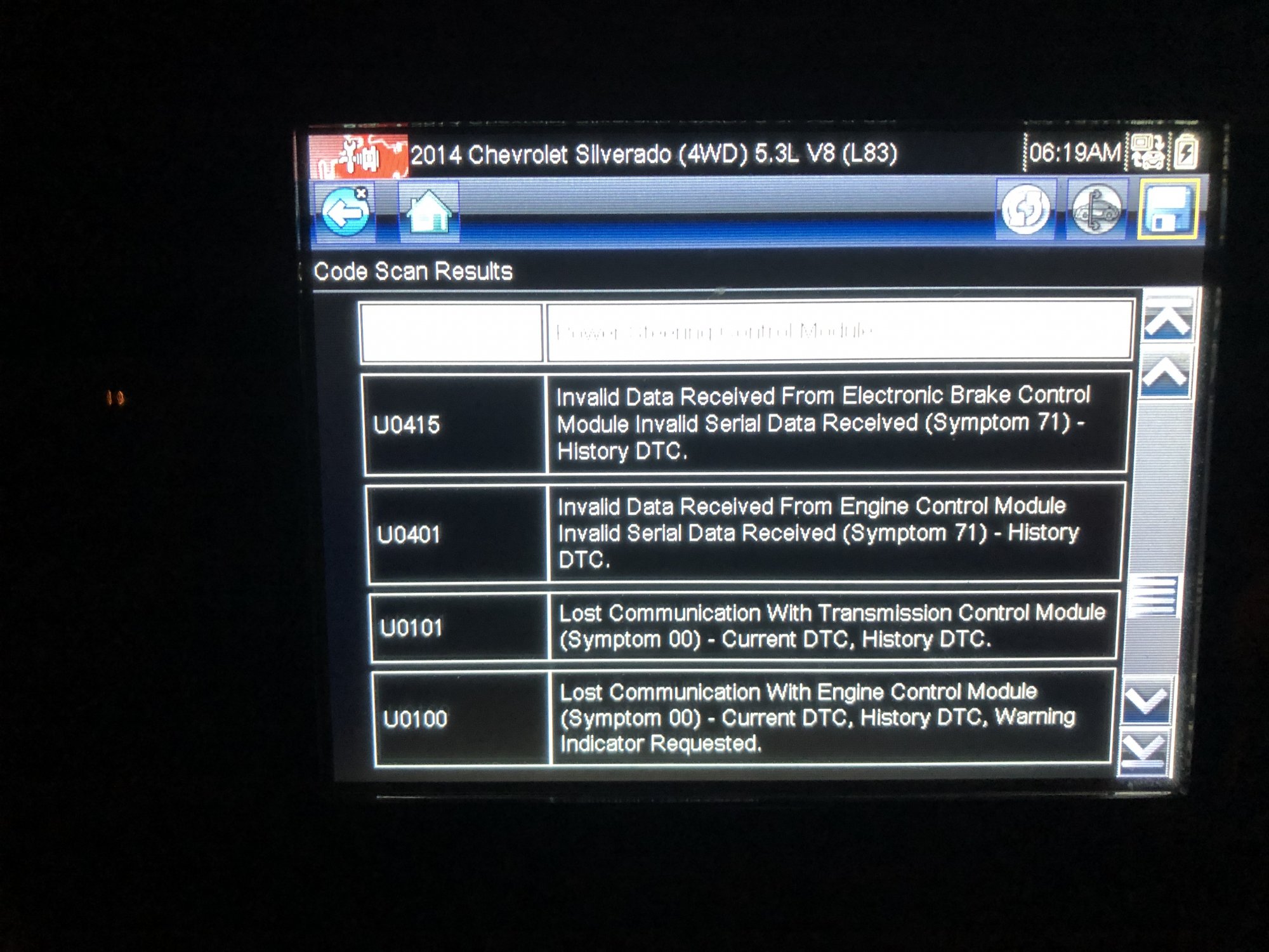

I have a 2014 Silverado crew can short bed let all stock. When the weather changes over night the next morning the truck won’t start. I loose communication to the ECM. It sets a u0073 code along with loss communication codes. I am stumped by this problem and don’t know if any one else has heard of this. Attached is the other codes I’m getting.
When this occurs I loose the PRNDL. All my gauges won’t sweep or move. I get the loss of power steering warning and my truck won’t start.
