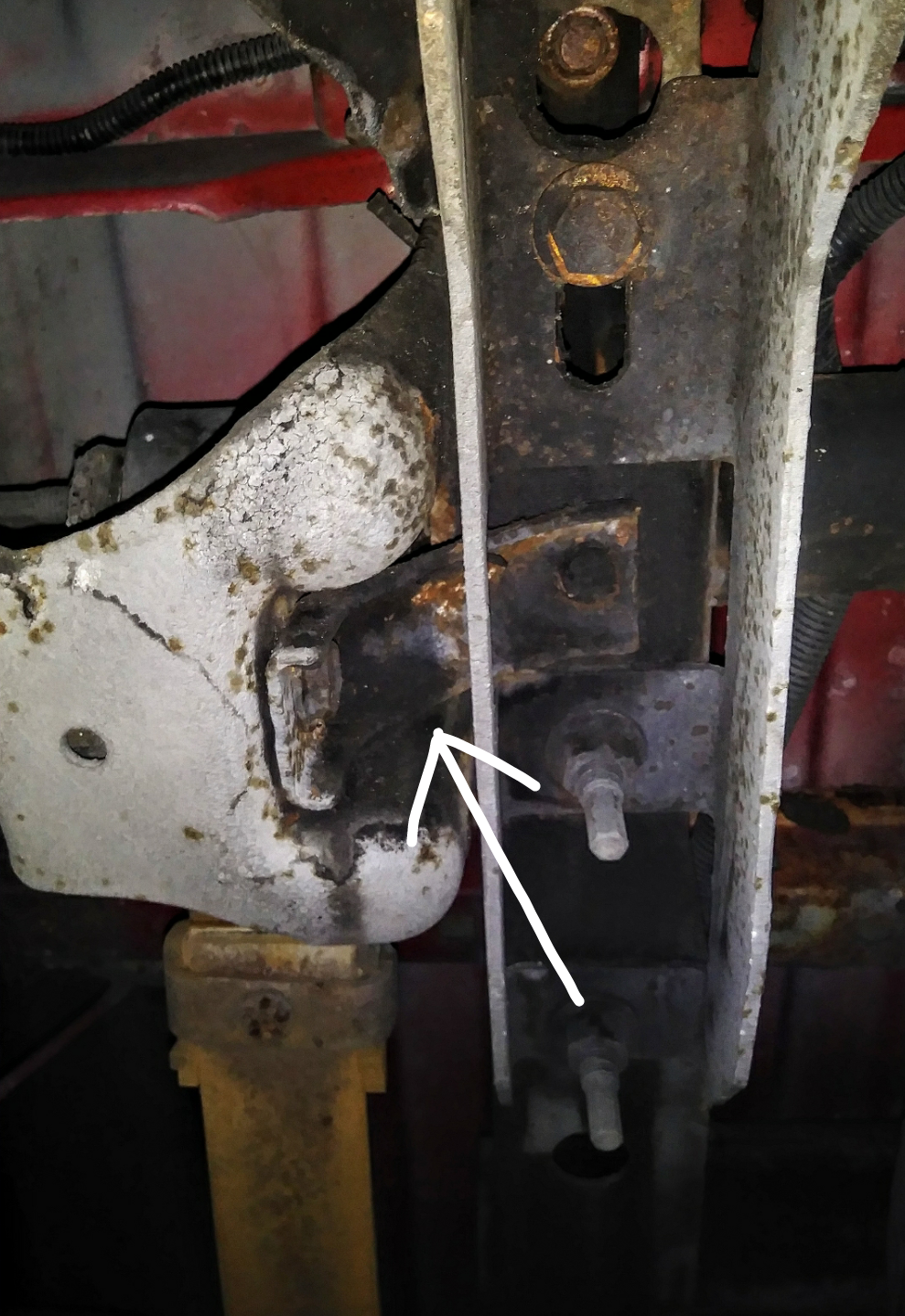

06 rear leaf hanger rust, can't find bracket
I am looking for the bracket that is riveted to the frame and connects to the rear leaf spring hanger with the lower shackle bolt. Anybody know of a part number for this?
My hangers, shackles, and these brackets were all so rusted out I was one rough bump away from my leaf spring being in my bed.

Wanted to give an update in case anyone else might ever need this.
The GM parts person hooked me up on the down low with a part number. It's "reinforcement 12474022" and it costs like $128 EACH bracket!
The lowest I found was EBAY for around $70.
$150 for 2 L brackets is a hard pill to swallow.
