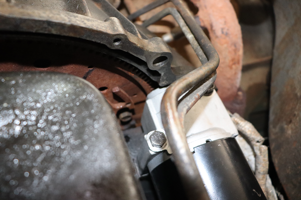

I did just loosen to install the shims but I can see the tThe teeth on the flywheel are good. Looks pretty. I put the whole pack of shims in there one at a time with no change along the way. I can't get a good picture but I can see it well.
In the 1 pic,to the left of bell housing notch,is that 2 shiny spots, from where starter gear is or was hitting
