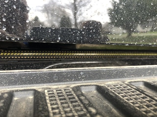

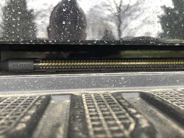

Here’s a couple close ups so you can see where it sits.
  • Thanks 2

Yeah, that bar is considerably thinner and narrower than I had imagined it would be. The YouTube vids that I saw on the installs show that it comes with attachment clips and the 3M tape. Did you use the clips or tape it directly on? Cant tell if that's one of the clips in the top pic of yours

I used the clips, I put the 3M tape on the clips and clipped them onto the bar. Then put the bar in position, made sure I had some alignment points (the center seam on the bar and the hole for the gate wire, the weld spots and those two openings) peeled off the backing and pressed on the bar where the clips are. I didn’t want to stick the whole bar on just in case it fails it would be a huge pain the butt to remove. The adhesive prep is awesome so be careful when you stick those 3M sticky pads on a prepped area. I did have to move one a tiny bit, but it worked out.
