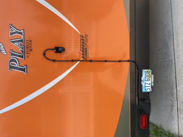

Transparent trailer uses an extra camera on the tailgate so should work with cap.
Truck would  have one camera for hitch view and one for trailer view.
If CHMSL has 2 cameras - it will be one for the 'rear view mirror' camera and one as a cargo camera that looks into the bed.
Neither would work with a cap covering the cameras  (but the cargo view would be neat if it could be relocating to inside the cap)
