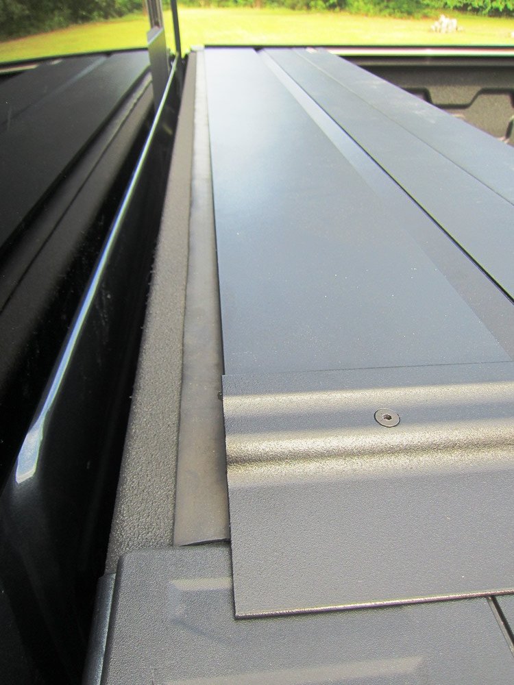

Here's the pics.

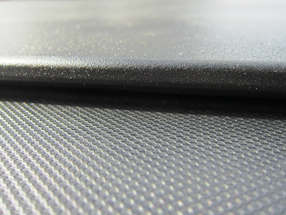

Closed, completed.
Rear tailgate top seal. Faces straight down and forms a lip seal on top of the tailgate.

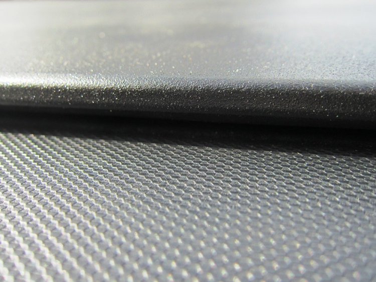

Tailgate closed. I think if you hit it with a pressure washer here, since the lip faces to the front, you could push water past it. Keep that in mind.

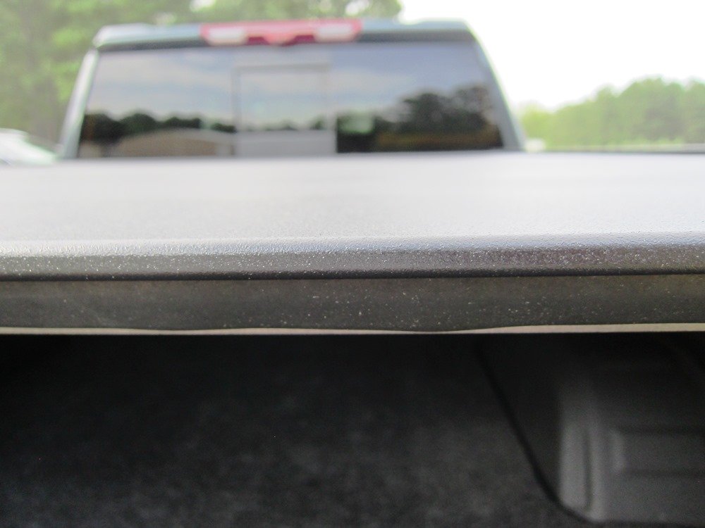

With fully closed, has a soft gasket on last slat to front header to provide for water intrusion seal-
And of course, the front bed lip seal. lots of contact area-

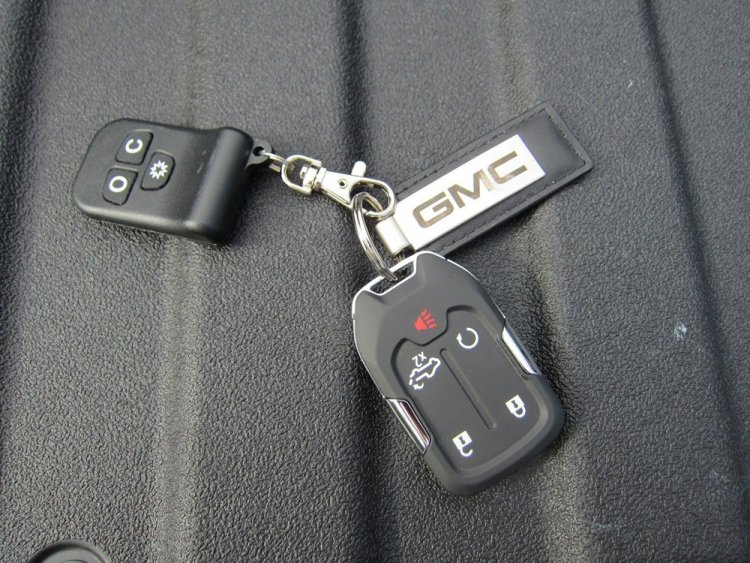

Key fob. Comes with two.

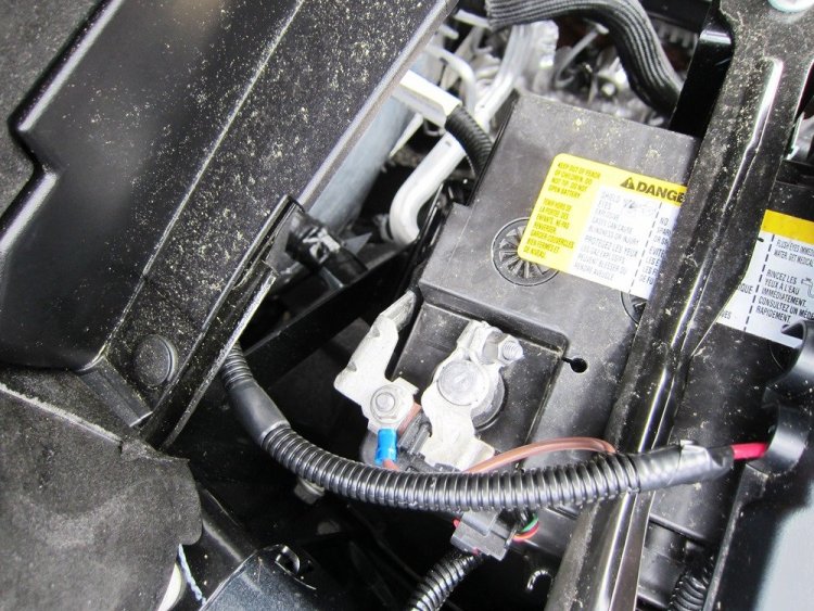

And the wiring to the battery. Brown to ground (neg) and red to hot (positive).  There's a 10A blade fuse under the cover that's not shown.
And ran the wiring behind the insulator pad on the firewall. A bit neater look than just throwing the wiring around everywhere. You can see the red/brown wiring peeking out on the right a little.

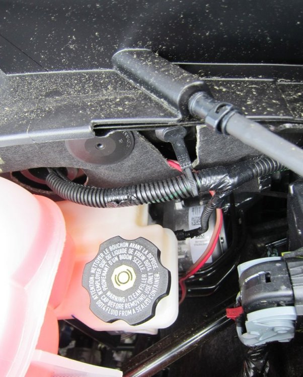

And finally over to the driver side next to the brake fluid cap. Runs down on top and back of the inner fender liner and on the outside of the frame strapped to the electric motor wire loom for the running boards.
