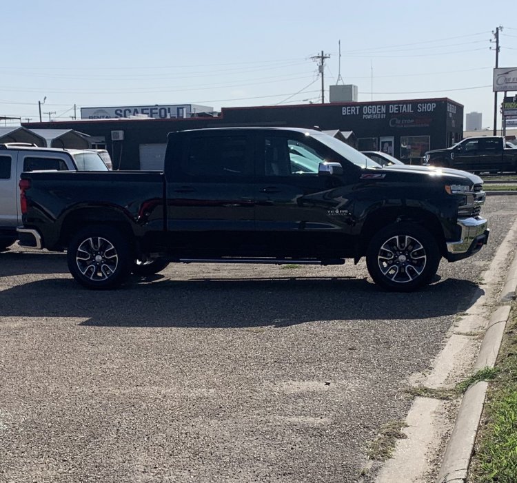

Truck is a 20 LT Z71 with the Zone 2” upper strut puck level up front and a ReadyLift 1.25” block in the rear. Prior to this I had just the ReadyLift lower strut spacer & stock rear but swapped that out due to CV concerns.
With the current setup I notice a very slight shimmy primarily when coasting.  The current setup was dealer installed & aligned.
Anybody experience something similar?

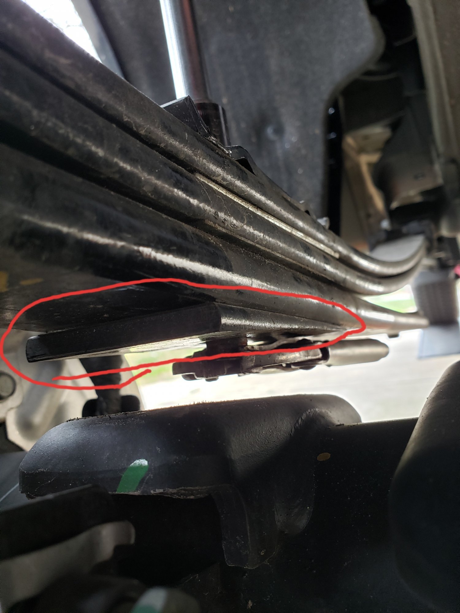

I put 2" drop shackles on my RST and had a vibration on decel at lower speeds.  My truck has a factory pinion shim and I just spun it around and cleared up the  problem.  There's a thread on this.  I don't think the 4wd's have the factory shim. Not saying it's not something else with your set up.
