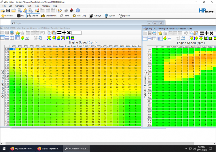

Hey guys! I have a 2002 gmc sierra 1500 Denali with the 6.0, cruising down the highway with the cruise set on 70 rpms at 1800 (4.10 rear end) i noticed on my scanner that my timing advance is staying at 50 degrees +- 1 or 2, is it just me that thinks thats too high for a stock truck? Saw on some forums people say dont go higher than 30 ish at wot? The truck is horribly slow and i read a bad MAF could cause high timing and poor performance? Thanks in advance!
Cruise timing and wide open throttle timing will be two completely different things.
Many calibrations will have high timing at cruising speeds to help with fuel mileage and because they use the EGR, seeing 40-50 degrees is not out of the question depending on engine rpm and cylinder airmass.
Timing at full throttle is usually around 18-28 degrees with variables. Things like commanded air fuel ratio, intake temps, coolant temps and knockretard can all alter how much timing advanced there will be.
A bad MAF sensor in itself will not cause high timing, it will just hurt performance.
Here is a stock 2001 GMC Sierra 6.0 file. If you look at the numbers it's roughly 38-40 degrees of timing at 1,800rpm and low cylinder airmass, then add in the 7-9 degrees that the EGR adds in you are near 50 degrees.
Ok i didnt know it would be different from wot to cruising, i will do a data log with my scanner tmr of some wot pulls and see what happens, the thing is a dog i calculated the 0-60 to be roughly 11 seconds and it has a 4.10 rear end. I saw someone said they took the tune from an 06 escalade and popped it on one of these trucks and it turned into a totally different animal, is this even do-able? wouldnt the different compression ratio from the lq4 to the lq9 cause issues in the tune? bare with me ive never tuned anything and dont own HP Tuners lmao im just trying to figure out why this thing is so slow and why with a 3000 lb trailer it wont go past 50 ish mph at 4000 rpm, wanna figure this because im considering dumping it for a duramax.
