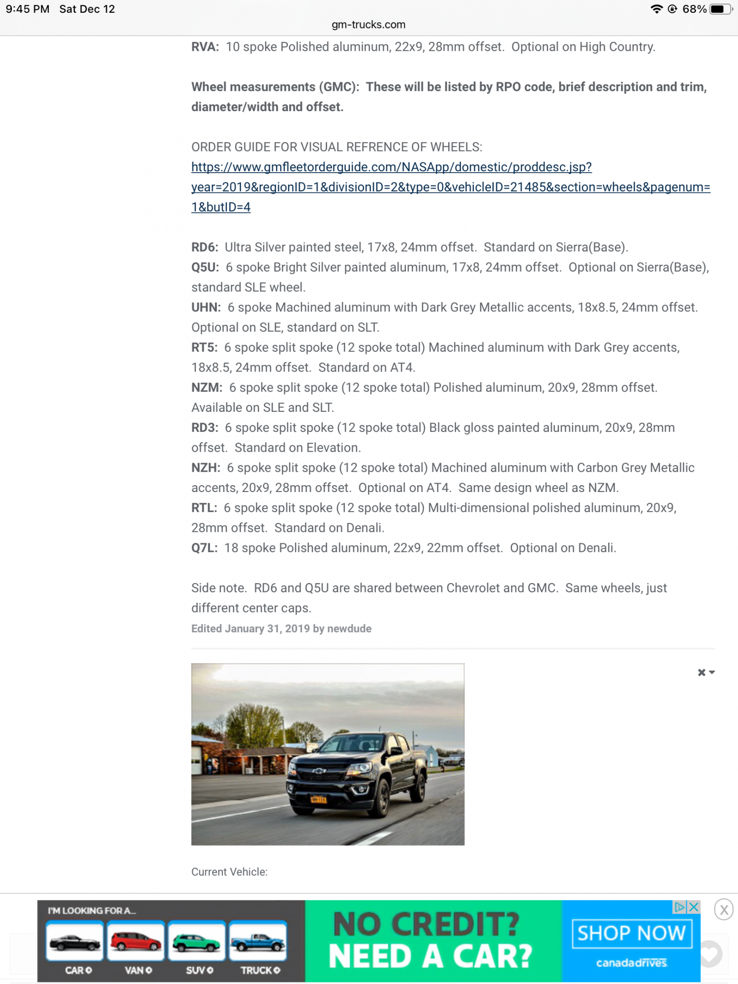

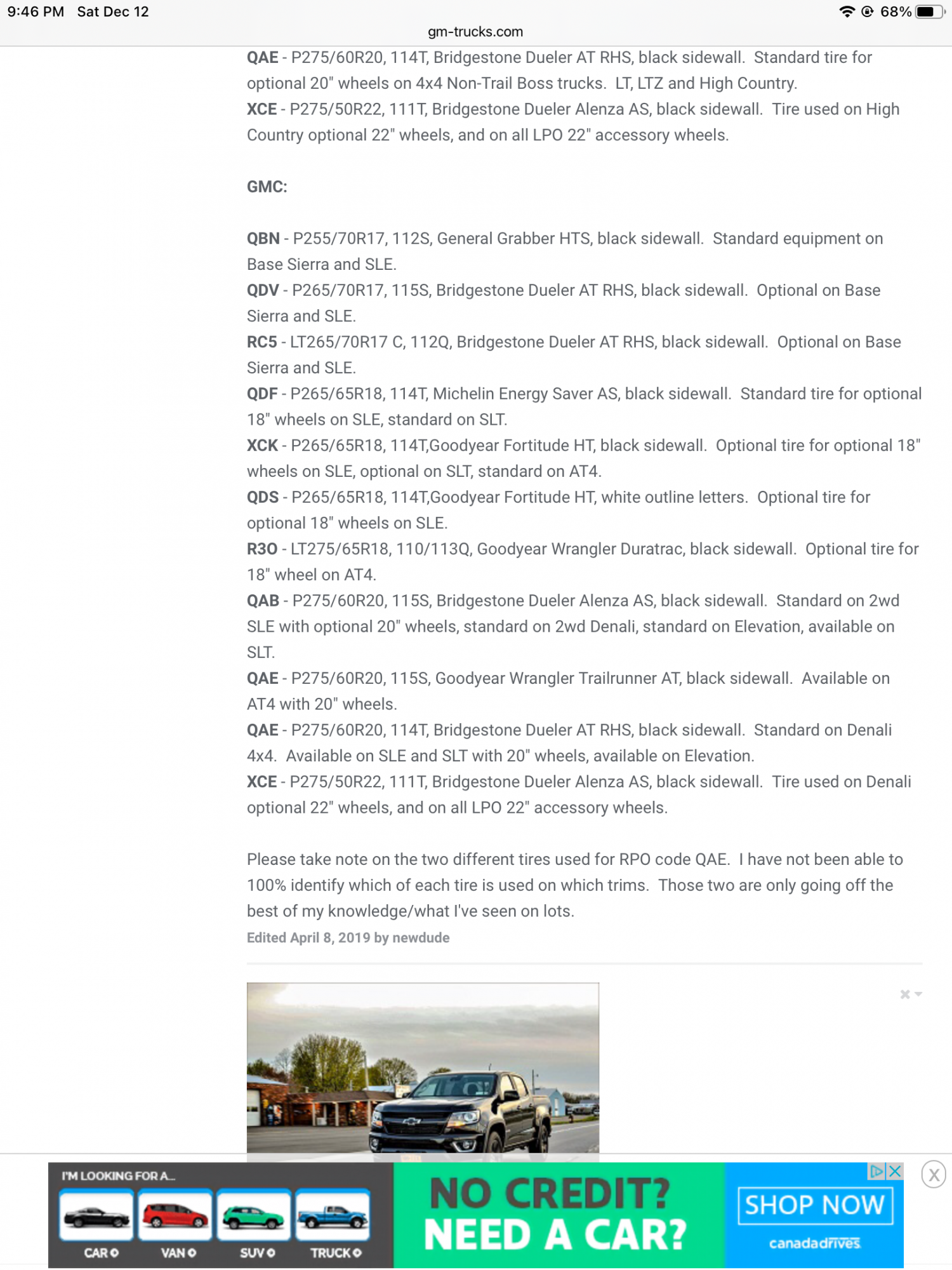

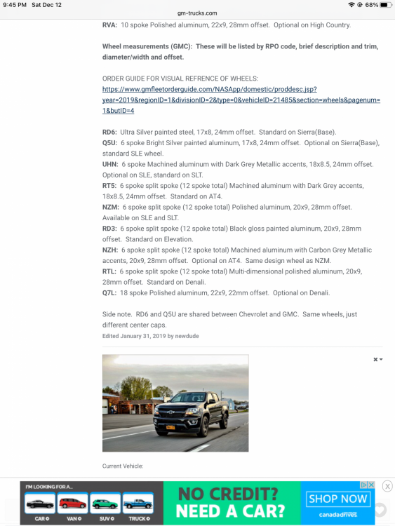

Those factory wheels are 24 mm offset. There is a topic here somewhere that someone posted info on all the wheels and tires. I have tried to attach a copy of pictures I took of the pages. Sorry I don’t know the weight.

Option code is RT5.  18x8.5 wheel, 24mm offset.  Shipping weight is 31.06lbs.  I'd take 2lbs for the packaging off of that.
