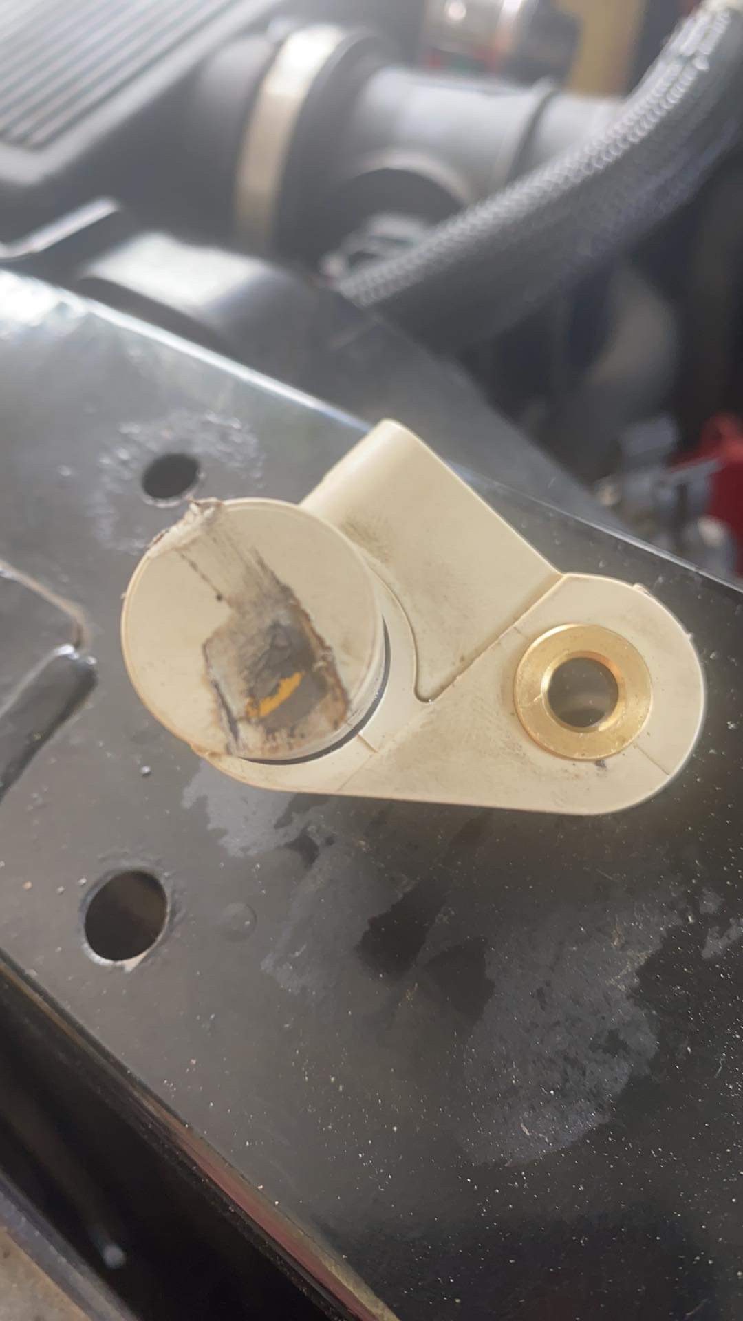

Did a DOD delete on my 2007 Silverado. Cranks but will not start. I have fuel pressure at the rail. I have spark. It will not start with starting fluid. I am not getting any cam data to my scanner? I replaced the cam sensor when I had the truck apart with a after market sensor. Any way to check and see if the sensor is functioning properly?
and before anyone asks the question, no I have not checked compression yet. I have to stop after work and get a new gauge.
I would try a OEM cam sensor. Get rid of the after market sensor.
If you're not getting cam data I would think faulty cam sensor.
What cam gear did you use?
Did you use the correct 4X cam gear? And did you tune it yet?
