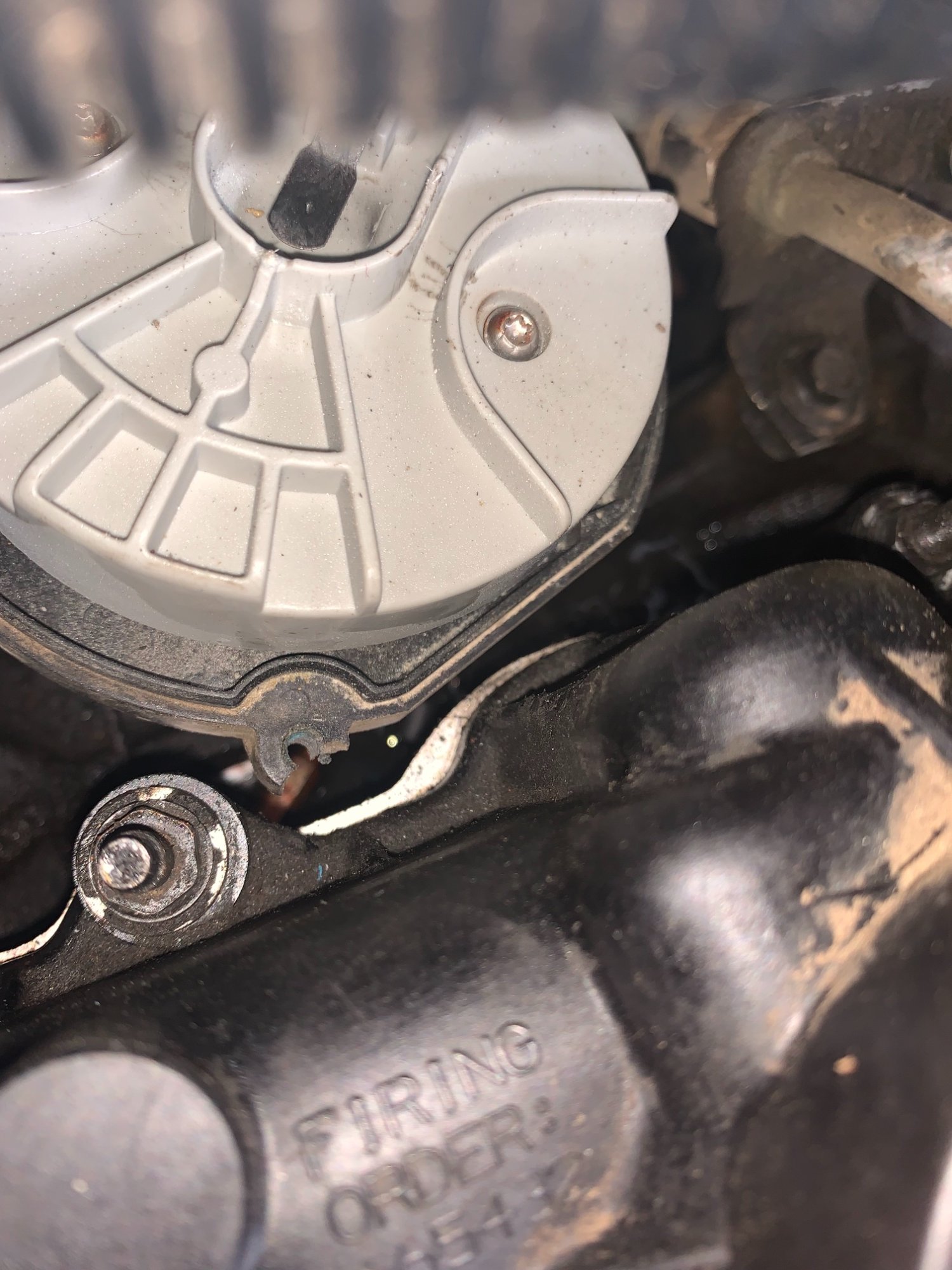

After fighting with it, I decided to change out the spider injectors. Made no difference. Changed the fuel filter just in case. No difference. After fighting with it all day, I got it to crank, but it wasn’t running the best, almost like it was misfiring but no codes. The next day it wouldn’t crank again,  I noticed one of the plastic tabs that the distributor cap screws into was missing half of it causing the cap not to sit tight and the pickups were corroded.

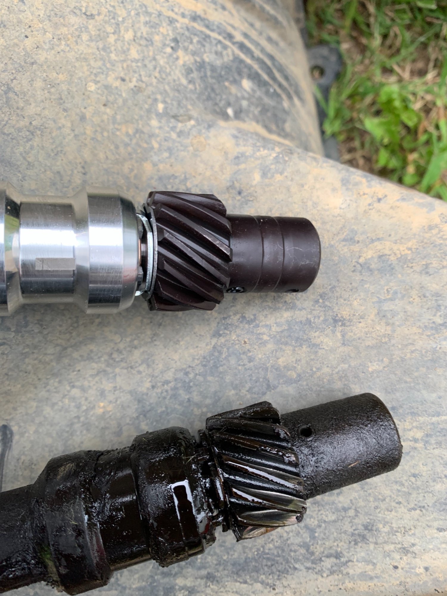

Changed the distributor to the updated aluminum style and still can’t get it to crank. At first I had trouble getting the distributor in time, but I believe it is in time now.
In the current position the truck will crank to a certain point and then stop. I changed the old battery out to rule it out, with the new battery it would crank strong until a certain point. With the distributor timed any other way, it will sit there and try to crank all day.

I have attached pictures showing the damage and wear on the distributor
Any advice on where I need to look?
