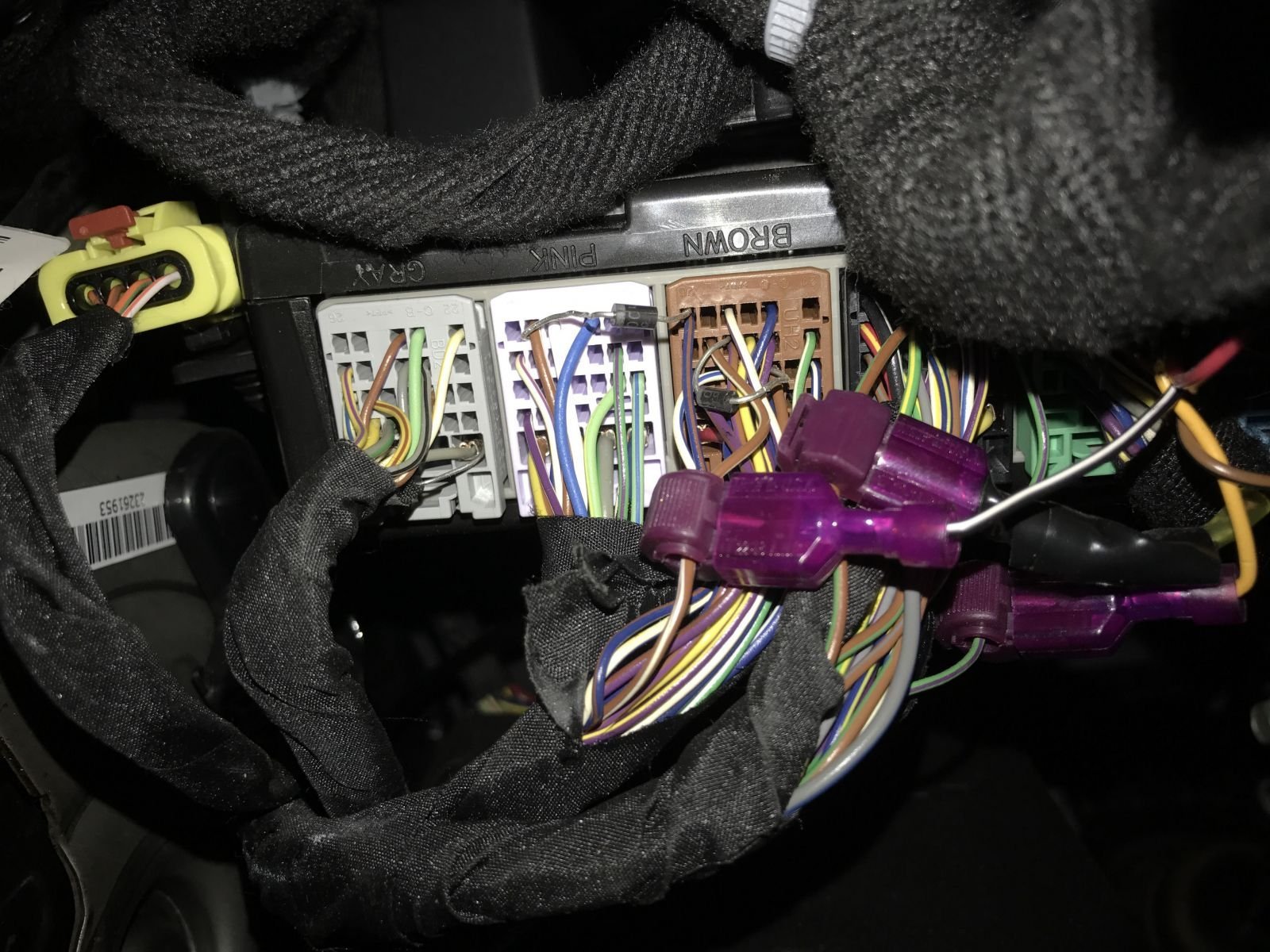

I’m new to this forum. I have a 2018 silverado LTZ. I recently installed fog lights that have drls. I’m looking for a location in the fuse box for a fuse tap that will work in conjunction with the existing drls. Any thoughts or advice would be appreciated.
This is your BCM, under the dash, above/outboard of the brake pedal.  Black-7 (Lt, grey wire w/ dark blue trace) & Brown-7 (Rt, dark blue w/ brown trace) are you DRL power points.
