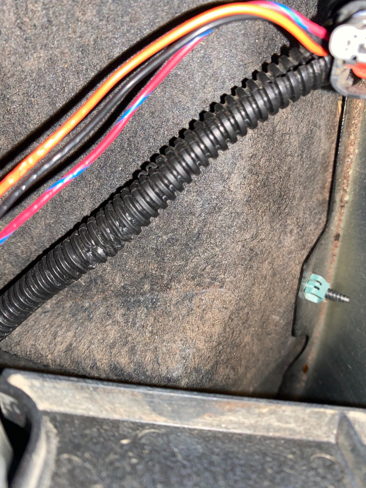

Found the problem. When my truck was last in the dealership for warranty work, they pinched the wires for the fender flare lights in the fender liner then put a screw through the wires. Of course they won’t accept any responsibility for their mess up. I’m out $360 but at least my lights work now.
