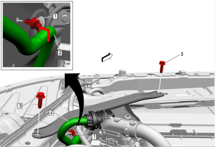

Does anyone know where the plug in for the block heater cord is on the z71?
I couldn't find the cord in the vehicle.
Edited by masspnr
Engine block heater is not a factory installed, rather dealer installed.
See below post
Edited by newdude
I just found the install instructions, the Z71 heater end gets tied up on the driver's side pencil brace under the hood.
