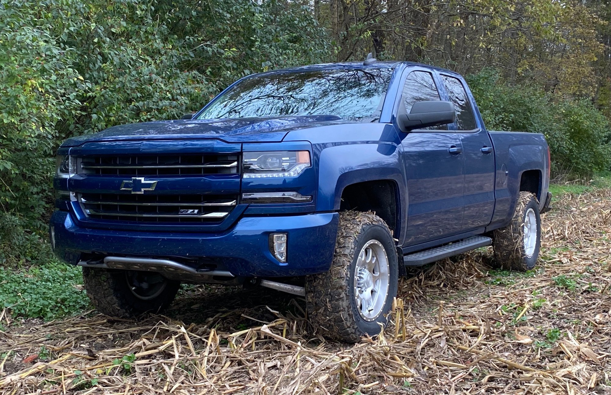

On my 2017 I went with 275/60/20 BFG KO2's and a 1/2 inch level and while looks are very subjective gives it the perfect stance.  I also trimmed the lower air dam in the front which gave it the appearance of being at bit higher and couple more inches of front-end ground clearance.  The GM performance exhaust helps finish it off with just the look and sound I was set on.  I'll try to find some decent pics to post.

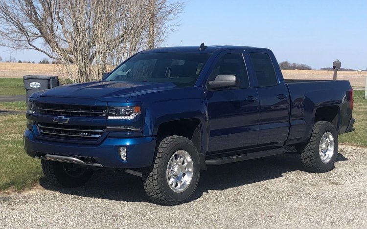

A 2” to 2.5” leveling kit should give you the look you’re after. The Traill Boss is lifted 2” over a regular 4x4 truck. I have the Eibach Pro Truck kit on my truck. The new shocks and springs raised it 2.5” in the front. I like a little rake on my trucks (1”-1.5”), so I swapped the stock rear blocks for 2” blocks. My 285/65/18 tires are basically the same height and width of a 285/55/20.
