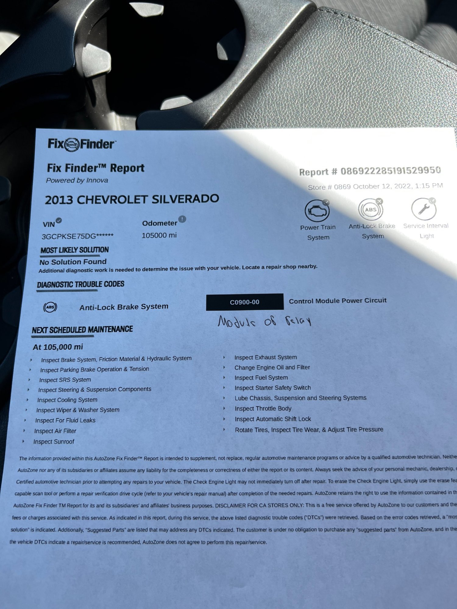

I had O Riley's check the battery and alternator. They both checked fine. I'm suspecting its one of the 7 modules that connect to the BCM. I just don't wanna go throwing money at replacing all 7 modules including the BCM itself. I'm gonna try calling a Chevy dealership and see if they can scan for any issues with the modules themselves.

I'm suspecting that its one of the 7 modules that connect to the BCM that's shorting out, are just bad. I'm also suspecting that its the BCM itself as well. The Battery was checked by o Riley's and is good, so is the cables. I've also checked ground straps, which have all been tight.
Update: Had a Chevy dealer run a diagnosis.
When they checked the negative battery cable, it came back to 400v. The tech said It should be 2v.
