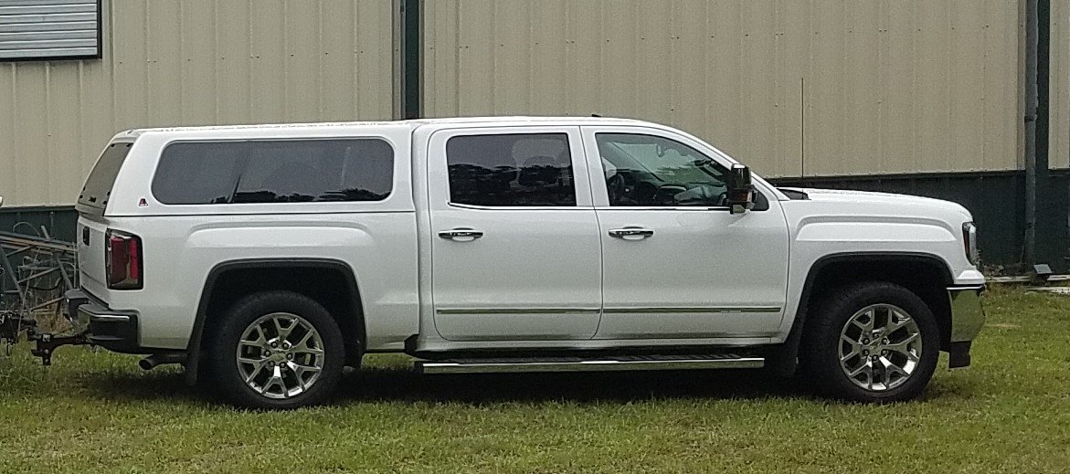

2017 GMC SLT with 6.2 and auto/dual zone HVAC. Stock as it came from the showroom aside from the cap and some window tint. 65,000 miles
HVAC fan will work fine for a few weeks, then it will decide to not come on when you start the engine. Mode changes still work, you can hear them cycling. Fan might come on the next time you start it, might not. May take 4 engine start/stops before it comes on again. Then it may work fine for a month. Been acting like this for about a year.
