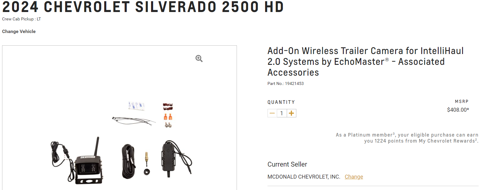

Hey Steve hope this camera worked for you, I just took delivery on my truck a couple days ago and somehow the camera didnt get ordered at the same time so I need to get one. I see they have a wireless camera available also and was wondering why you didnt get that camera. Do you know if they arent as good as the solid wired cameras?
