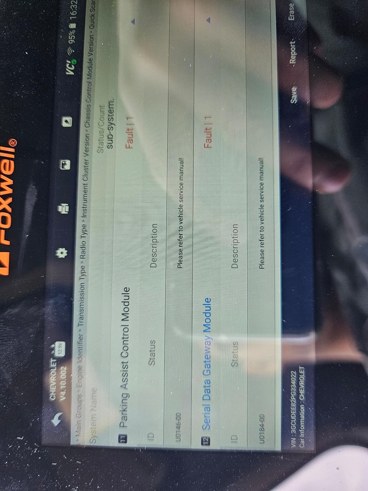

System is Bose. Initially I shorted one of the speaker wires which threw an amplifier code. I was able to erase those and the speakers worked.
Something didn't sound right however and I noticed the the driver side polarity was reversed, solving that mystery.
I fixed the polarity only this time I did not accidentally short anything and the amplifier still showed 2 codes. I cleared them, only now I still have no sound out of the corner dash speakers.
I also have these 2 codes I cannot clear.
Any ideas?

U0146 - Lost Communication with Serial Data Gateway Module
U0184 - Lost Communication with Radio
What aftermarket components have you installed to the truck seeing you are messing with speakers and what not?  If nothing aftermarket has been installed, your shorting pissed off either the radio or the amplifier and are no good anymore.

Just the speakers.
Amplifier shows no codes so I assume it must be the radio.
However, the dash speakers wire directly to the amplifier. There is nothing in between. I don't see how it could've jumped the amplifier (which is code-free) to the radio.
Must be something else.

Are there any other codes in any other modules?

Yeah there's U0447-00 something about video processing.
this one I can clear, but it always shows up again

Hmm.  U0447 - Invalid Data Received from Serial Data Gateway Module.
Have you installed the factory speakers and still no sound?  Do you have sound out of the rears, doors and sub?
To me, I'm still thinking something during that short took something down.  B+ to the front speakers out of the amp, and perhaps that spiked back onto a data circuit to the radio.  Circuits 4758, 4757, 7215, 7214, 7211 and 7210 go to the amp, radio and gateway.
In the end, sounds like you might need to put the stock speakers in and drop it at the dealer and see what they come up with.
