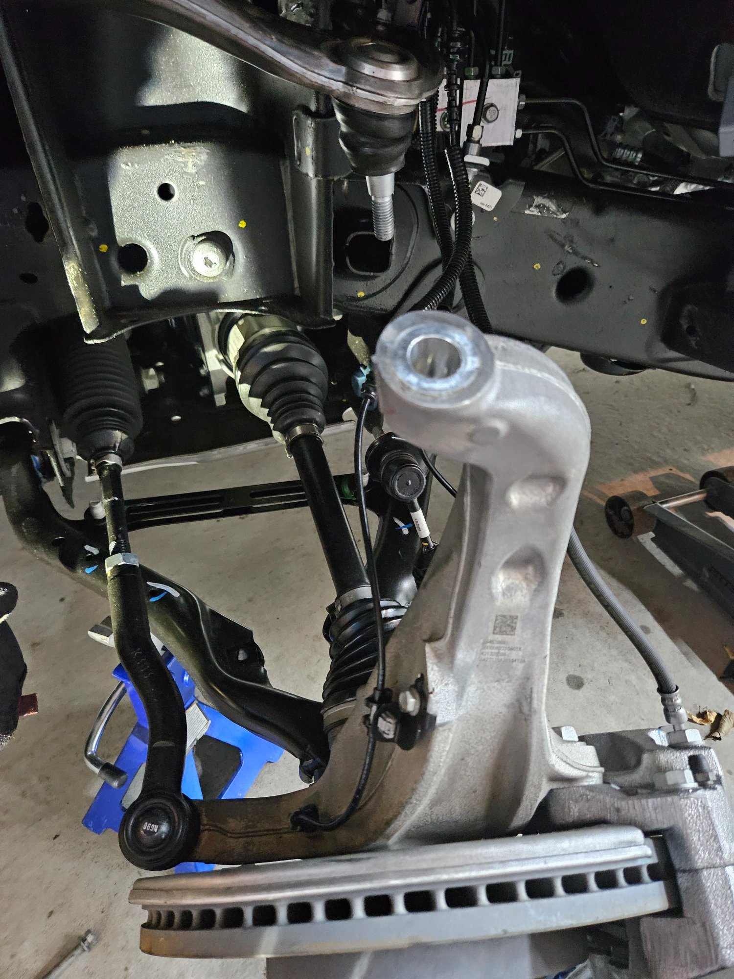

Speaking of driver side, these holes on the strut do not match the truck... or, the T bar on bottom needs rotated the other direction so I can rotate the shock around.
Emailed the seller...
A second issue here, how do I pop the CV axle back into the front diff? It popped out a bit when I was manipulating the wheel hub.

Got it...all of it
