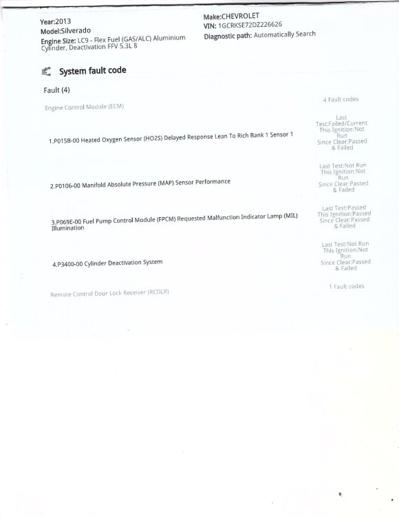

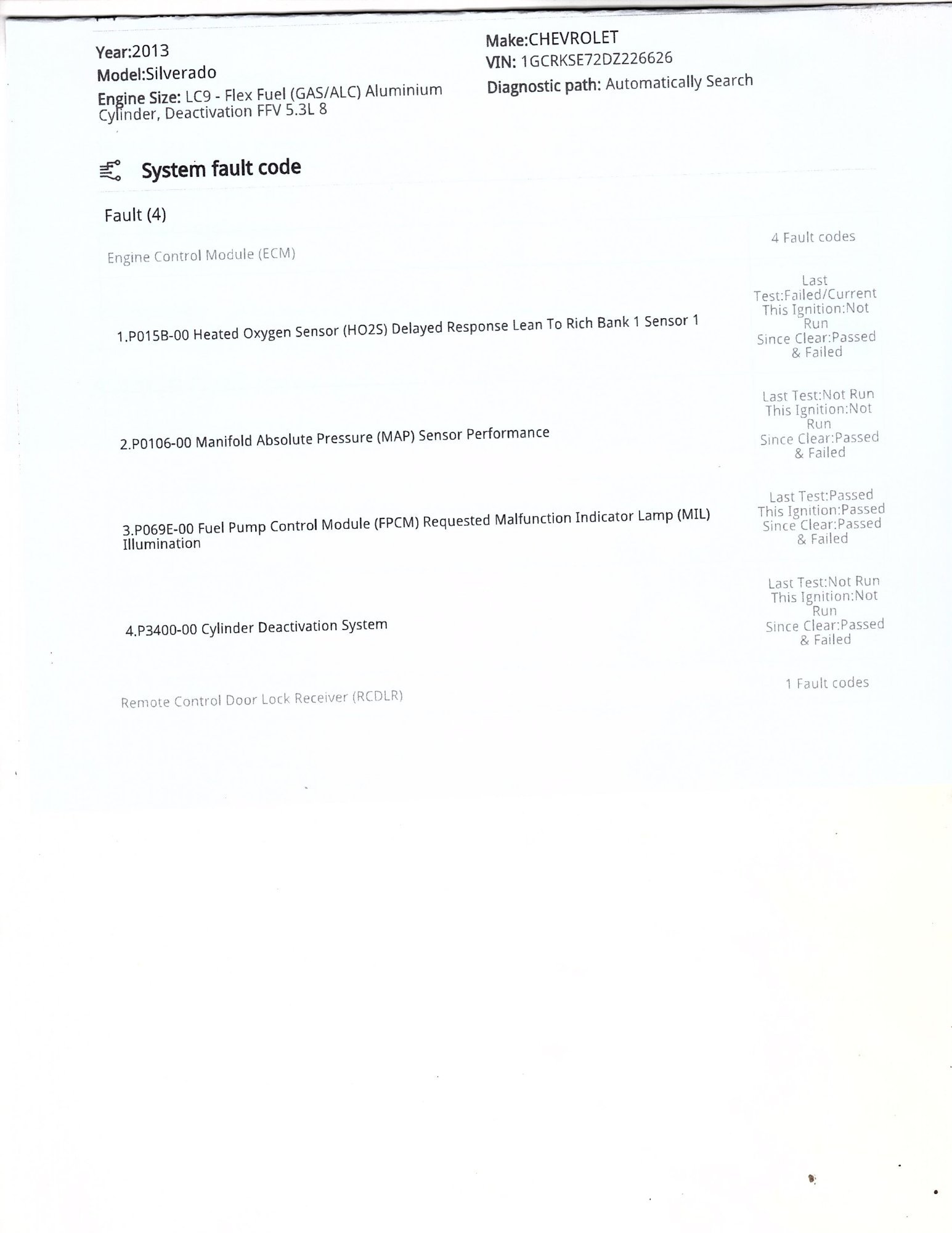

I was leaning twards this 13 ex cab, with the 5.3 . The guy said he had the afm delete done last year, well, i dont think all these codes should be present if it was done correctly, and have been reset so many times. Bummer, it seemed like a good running truck , but ive been fooled before with the afm stuff.
Is the check engine light on?
Those look to be history codes based on the wording on the side. And if the AFM system was deleted but not tuned before hand, there will forever be a history code of the AFM system. The only way that code goes away is if you installed the parts again so it can pass the test. The AFM has to be turned off with a tune prior to removing all the parts and starting the truck, otherwise it will always look for that system to pass the test because it will fail on the first ignition start if you don't turn it off.
