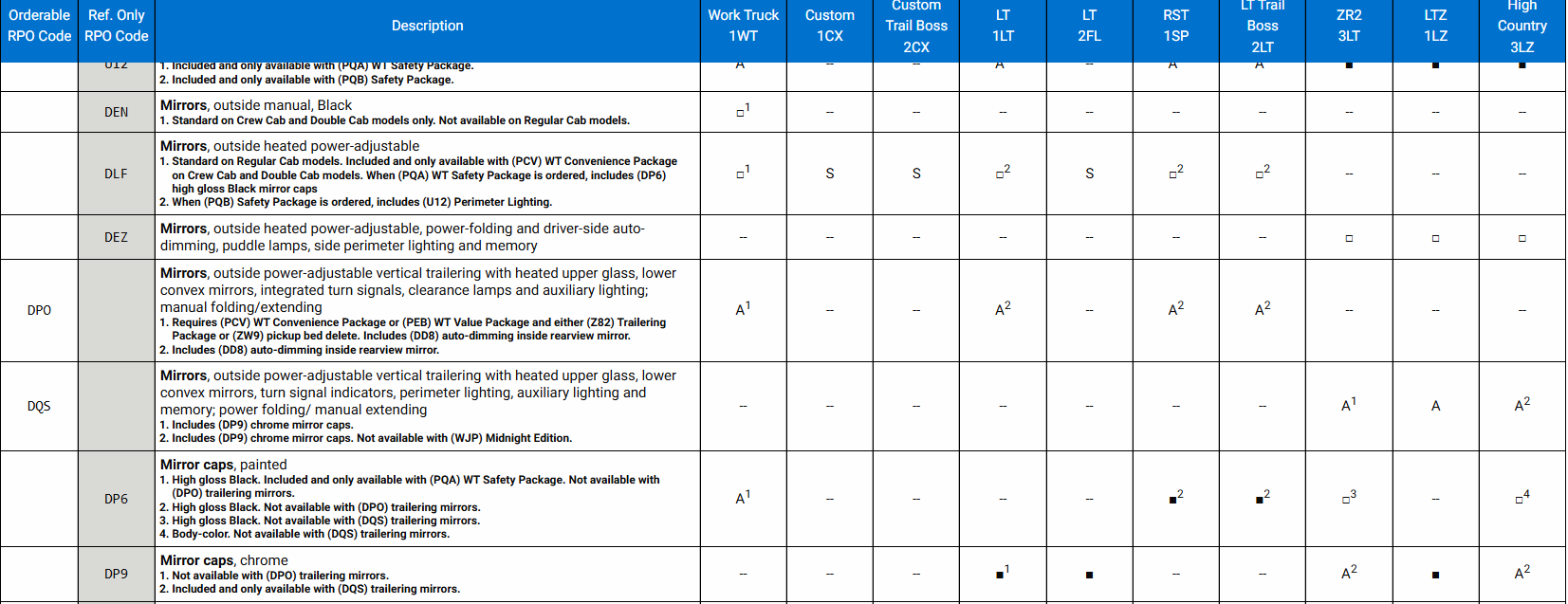

I’ve checked the threads and I don’t think anyone has figured out how to get OEM tow mirrors for the 24 with power fold, blind spot camera, etc… Does anyone have part numbers or info?
besides the boost mirrors.
Have you asked for 'price and delivery' at your favorite GM dealer.
Not sure if they currently have this, but they used to have a GM chart that showed what mirrors could be added to what trucks, with the corresponding part numbers for everything needed.
2024 1500 mirrors:
image.thumb.png.9fe085eae752f0d0d1d1597a931ad90a.pngimage.png.38f840483e45f019f44e6a9a5c700905.png
