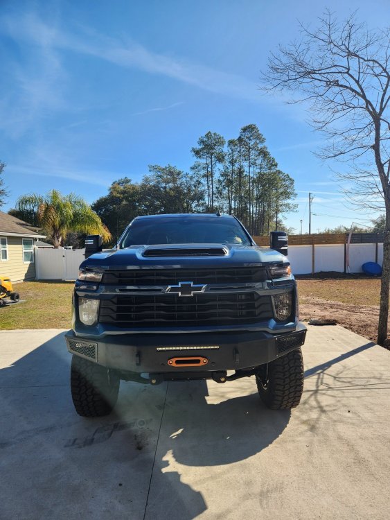

I hated the holagen front end since the day I bought my truck. I looked all over the internet for someone who had done the LED swap but couldn't find anything besides people asking about it or people saying it's been done with no pictures or info to back it up. Used parts for the 2024s are becoming more available now and I finally gambled and bought what I hoped I needed. I found both headlights, the grille and an upper bumper fascia all on ebay from salvage yards and bought the harness from gen5diy.com. that's all you need.
Take off the top grille/vent piece under the hood, just some plastic clips.
Take a few screws out of the front of the fender liners, about to the center of the wheel well.
Pop the wheel well trim off to about the same spot (more plastic clips).
There's one tiny screw (7mm) where the bumper fascia meets the fender underneath the wheel well trim.
The bumper fascia then pops off, lots of little clips so you have to go slow and work your way across it with a bunch of gentle pulls.
The grille then has 4 10mm screws on the top and 2 in the bottom corners. Then more gentle pulls to pop it off.
Lastly the headlights have six 10mm screws around them.
There's some videos online about removing grilles and what not that helped me some. I ment to take pictures or record the whole process but I got on a roll and kinda forgot. I know I would of really loved this information a few months ago so hopefully I'm helping someone out by sharing.

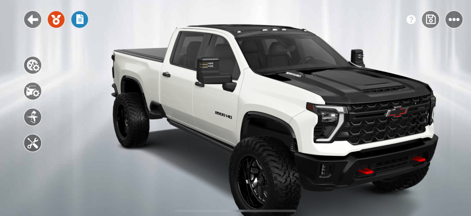

thats awesome!! thank you! ive been wanting to do this for forever now! I have a 23 midnight edition and have been doing research everywhere for months cuz I wanna do this after my 73 camaro is finished this year here what im gonna make my truck look like when done. so this is awesome man thank you so much for this I literally started looking again and seen you post this like a hour ago so it was a sign lol
Lol i spent so much time looking this up and found pretty much nothing, that's why I wanted to post this. I do know the 23s are different.  Gen5 has a different harness for them and I know the front bumpers are different. I'm not sure about anything else. That picture looks cool though

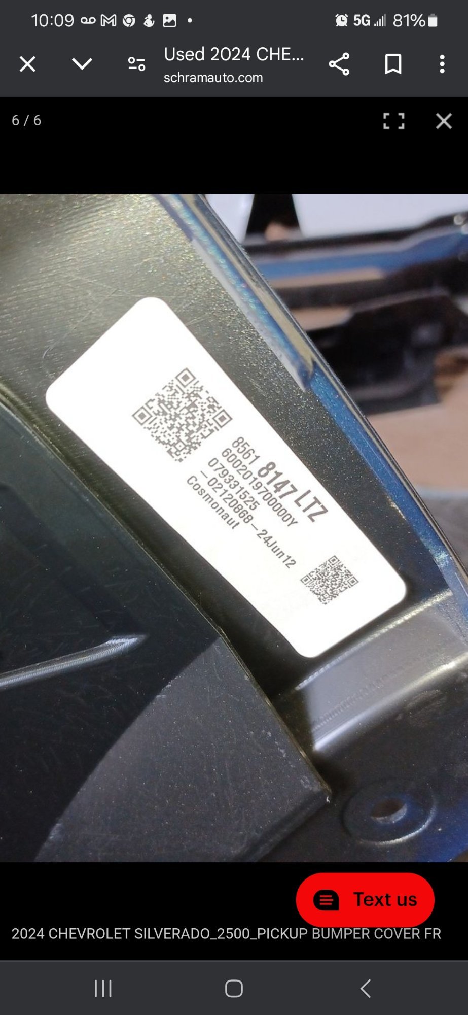

7 minutes ago, OS RR said:
By chance can anyone dig up part numbers for said parts?
This is from the bumper fascia. That's all I got though. Headlights are easy, I believe they're all the same. Grille just has to be for an ltz or high country
