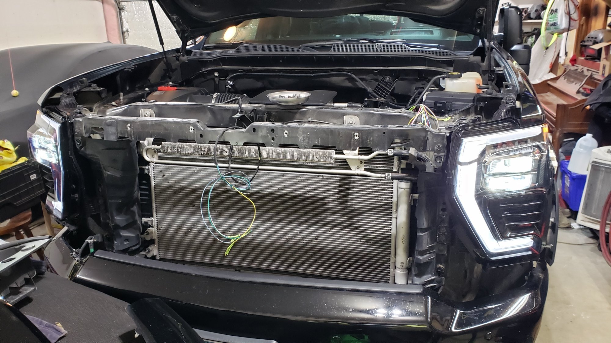

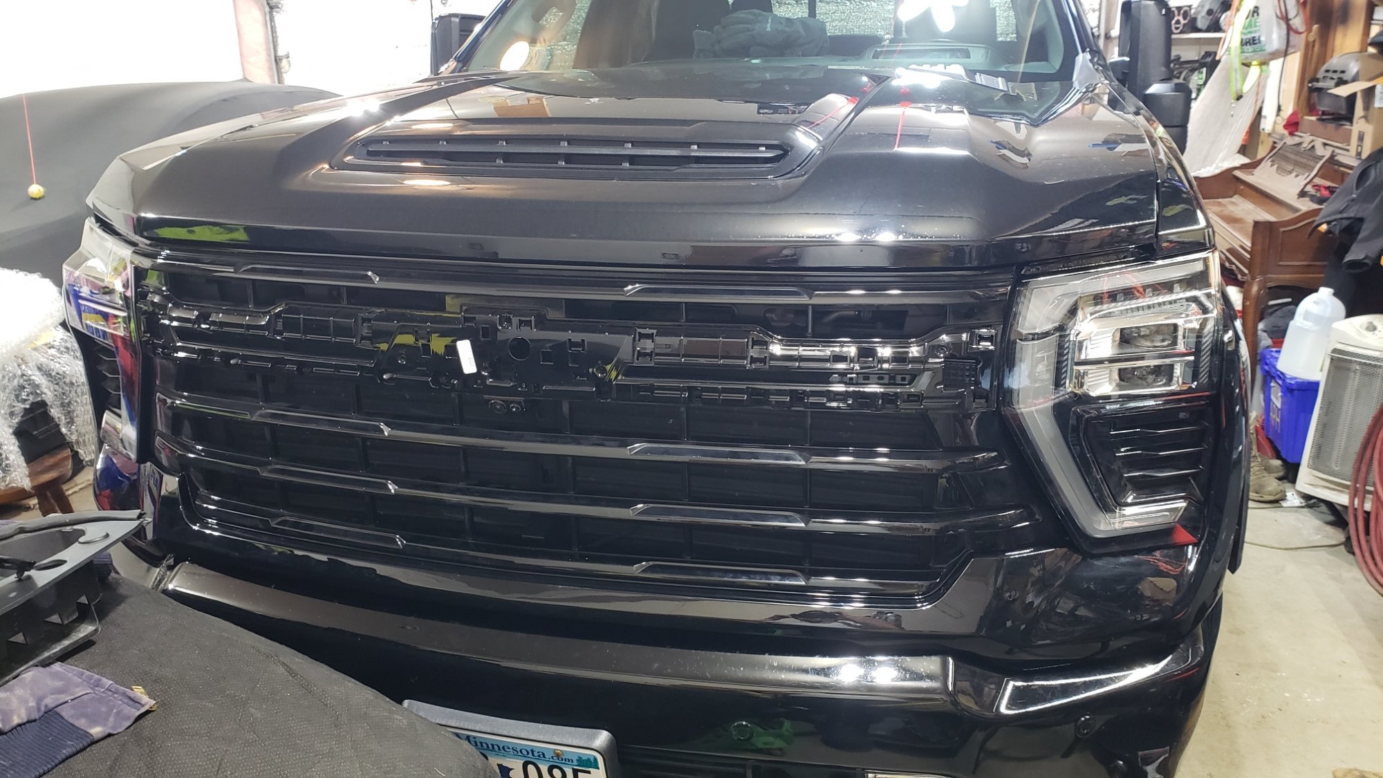

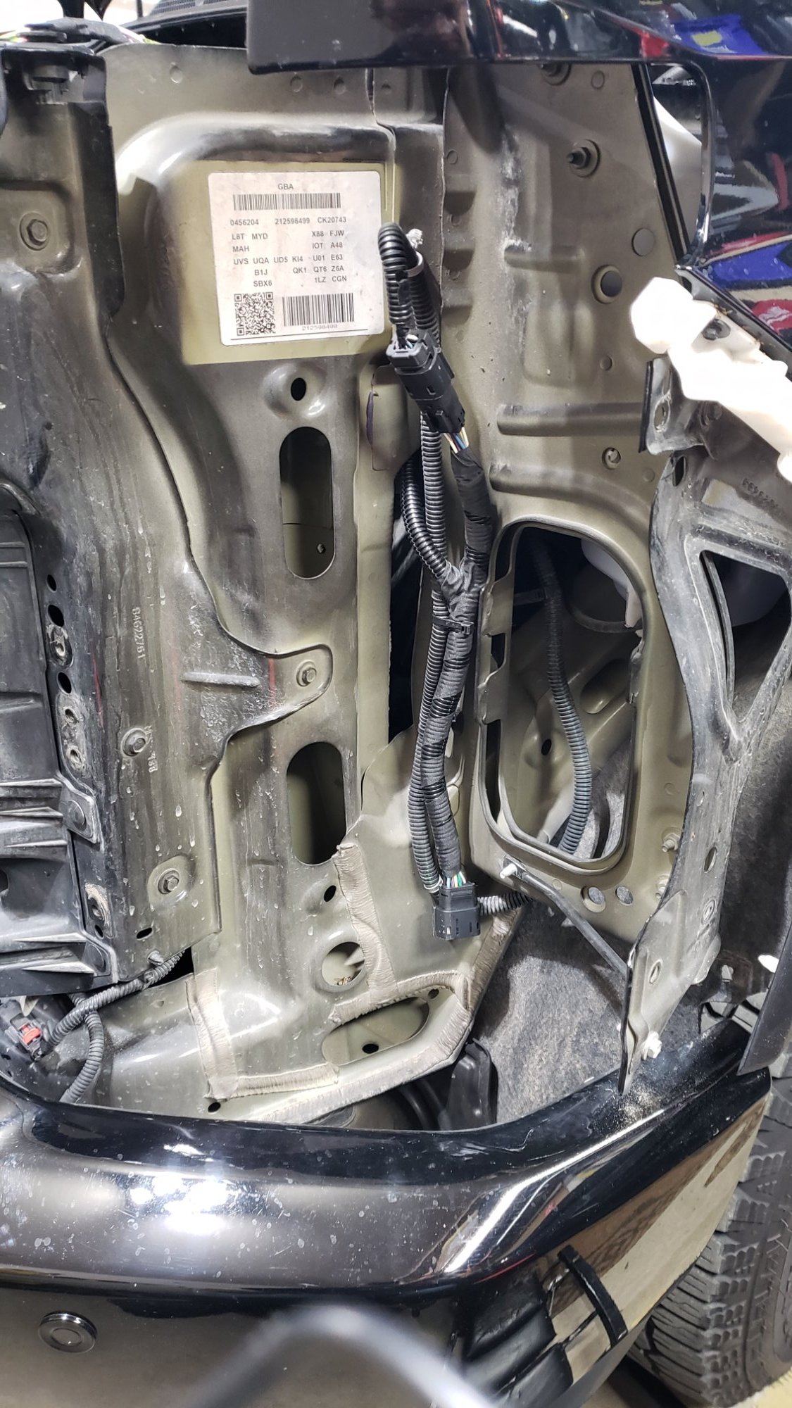

Sorry to hijack, but this is my little conversion. I built the plug and play harnesses myself. My truck ('21) was originally equipped with LED headlamps, which makes the wiring a little bit easier when compared to converting from the stock halogen lights. In that instance, you need to add a relay for the DRL function. Also, if you want the welcome animation to work, you just need to apply a 12V, 70hz, 60% duty cycle to the "animation" wire. Thats it.
Edited by carkhz316
I forgot to add that the auto high beam works just fine too. Also, the front grille cameras may be incompatible. I had to reuse my original as the new one just showed black/ no image. The coax connectors are the same, so the camera can be swapped from the grille itself easily.
Edited by carkhz316

Just out of curiosity, where did yall mount the resistors and relays that are on the gen5diy harness? I'm getting ready to do the swap but havent research where to mount yet.
