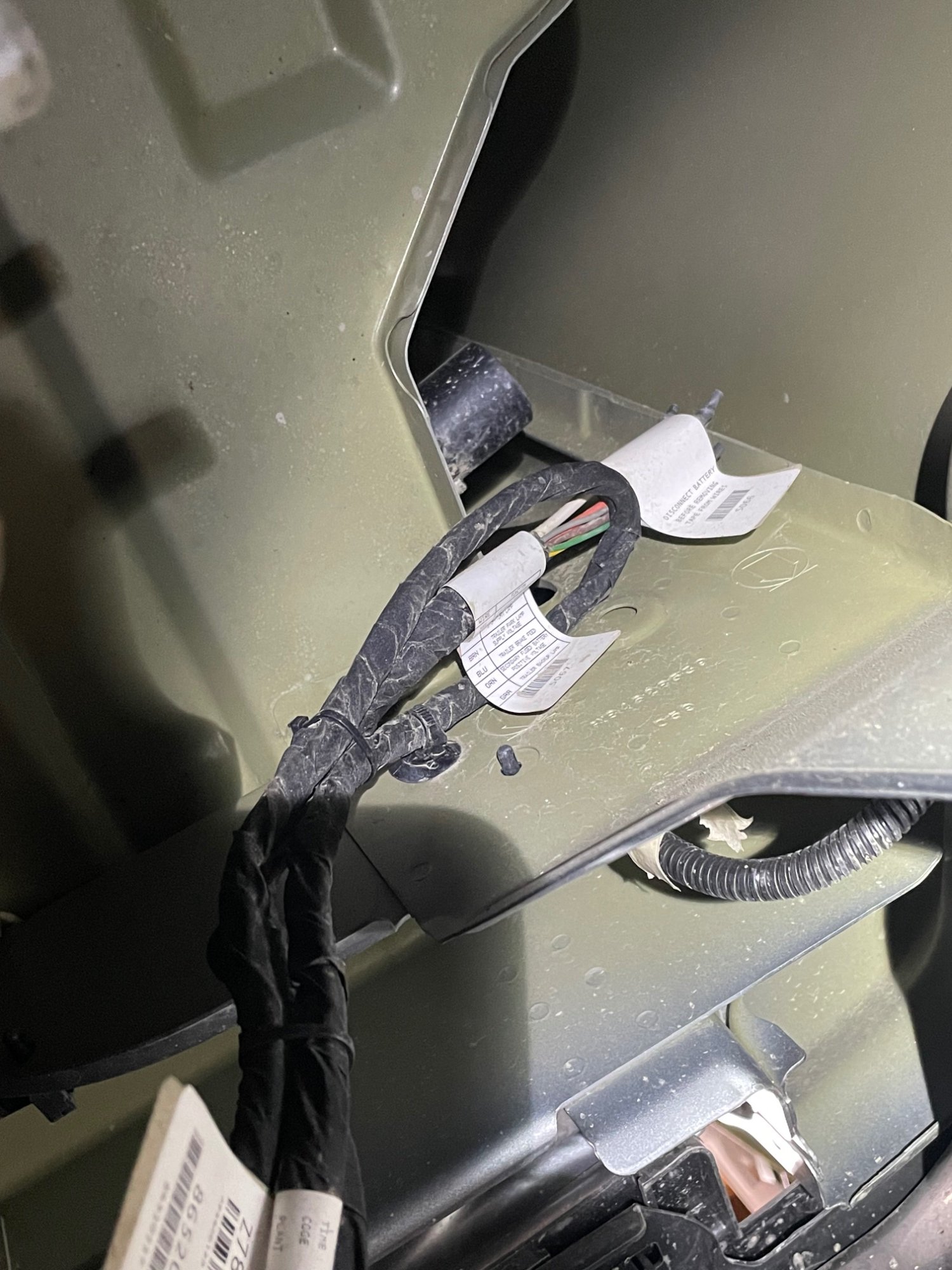

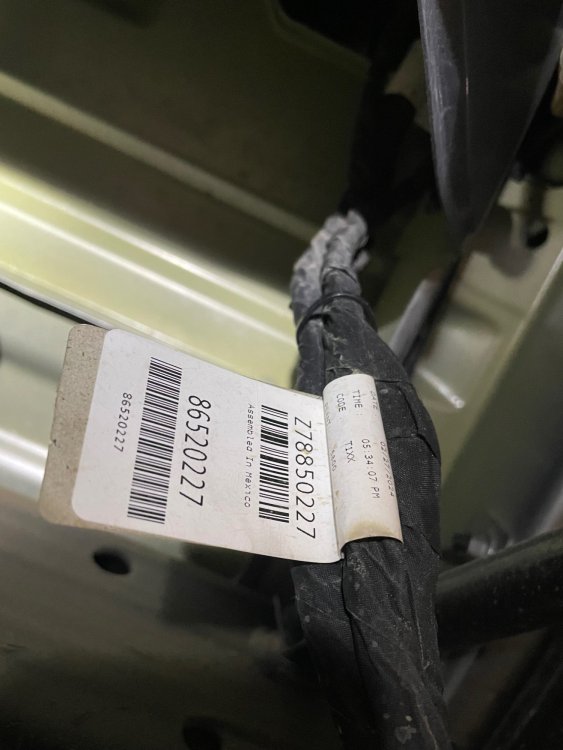

I ordered a curt harness/plug but I just realized the truck is partially wired for the gooseneck plug already. There is a harness with extra wire that runs up to the plug location.  Looks to be part number 86520227.
Does anyone know what else I need to complete this as “factory”? Do I just need the tow receptacle (I think part 84056018) and then I connect the wires I have into that? Or is there an intermediate adapter/part as well?
My harness part number doesn’t line up with the older thread linked earlier, but I’m assuming because I have a 2024 refresh truck and that thread was 2020.
