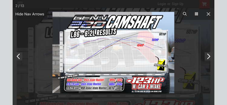

You gotta keep in mind too, that a msd with a tune likely makes more torque than an l86 manifold with a stock tune. Or at least the difference in power isn’t as dramatic.

I'll assume the DOD delete cam in the graph has the stock lift. It makes 450 ft/lbs from 2000 (with headers and E85). With your setup, heavy tires and a level, you'll be sluggish off the line with the MSD and cam. It doesn't make 450 until about 3000, and it makes the least peak torque.
The MSD intake is $2300 for 47 HP peak, and it makes it above 6000. I have upgraded push rods and valve springs and I shift at 6100. If you want to spin faster you might have to upgrade everything in the heads.

I hear what you’re saying, I just feel that 30 ft lbs loss isn’t going to be that dramatic compared to a stock 6.2. At full throttle you spend what; a second under 4500? After that all you see is 4500 rpm and up.
I blow the tires off as is, less torque down low will actually allow me to hook up, climb rpm and then I’m laughing.
