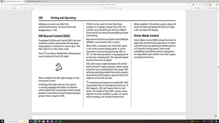

"HDC can maintain vehicle speeds between 1 and 22 km/h (1 and 14 mph) on grades greater than or equal to 10%."
Thanks, Newdude, for setting me straight. I don't know how I missed that part about the grade percentage. That must be it. I remember using HDC on long boat ramps last year when the lakes were low, and it was nice, and it always worked, but I bet boat ramps are steeper than 10%.
This year I've been frequenting a lake that has some pretty steep grades going around its dam to the launch ramps. Instead of pumping the brakes, I remembered I have HDC, and when I tried it on the last 2 trips it only worked sometimes on the same grade. I bet it's because that grade is just about 10%. I have HUD so I will set it to the appropriate display to monitor the grade.
