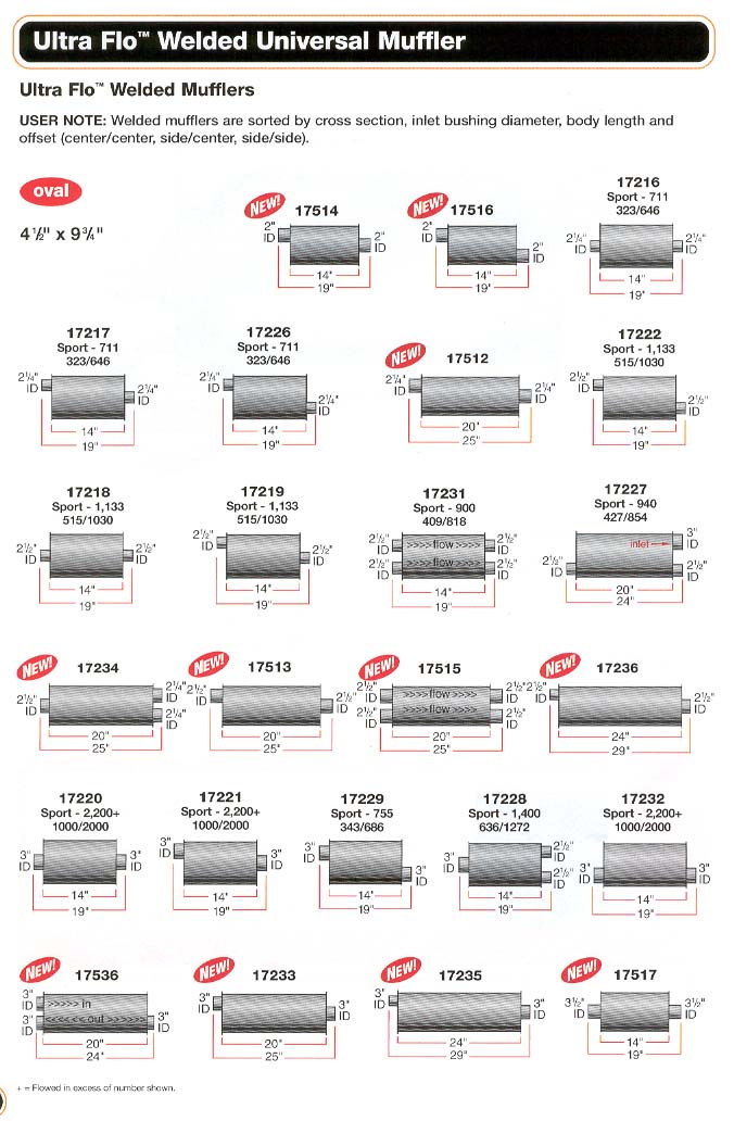

I wonder if this muffler from DynoMax would be a correct fit for the 6.0L Guys...  ???  The stock muffler on my 6.0L has a can that is 25" long.  The part #17515 would be a little short, but a small spacer pipe could be added.
ok now were are getting some where. You ad reducers or a cross over in front of the muffler . find a tail pipe to go out the other side ( just have the muffler shop do that part, much cheaper)Waalaa dual exhaust. food for thought
Heck,  I was thinking just the muffler from DynoMax would do the job...  (granted it wouldn't be duals), but we already have a beautiful 3 1/2" ID slash cut tailpipe on the 6.0L that would be more than capable to carry the flow out the rear.  :D

I'm just gonna pass my 2 cents on about my Dynomax experiance. I had the 17228 Ultraflow welded muffler on my truck, with and with out dumps and I did not like the cab resenonce at highway speeds. I do think it was a kick butt performing muffler, but just not to my liking. I went with true dual Magnaflows and have no complaints.
I'm not interested in having any cab resonance.  I wonder if the DynoMax dual in dual out muffler would be the same?
Does anyone else know of an aftermarket muffler that would be dual in dual out?  I don't really want to hack up my stock exhaust very much, and would like to just replace the "can"...
