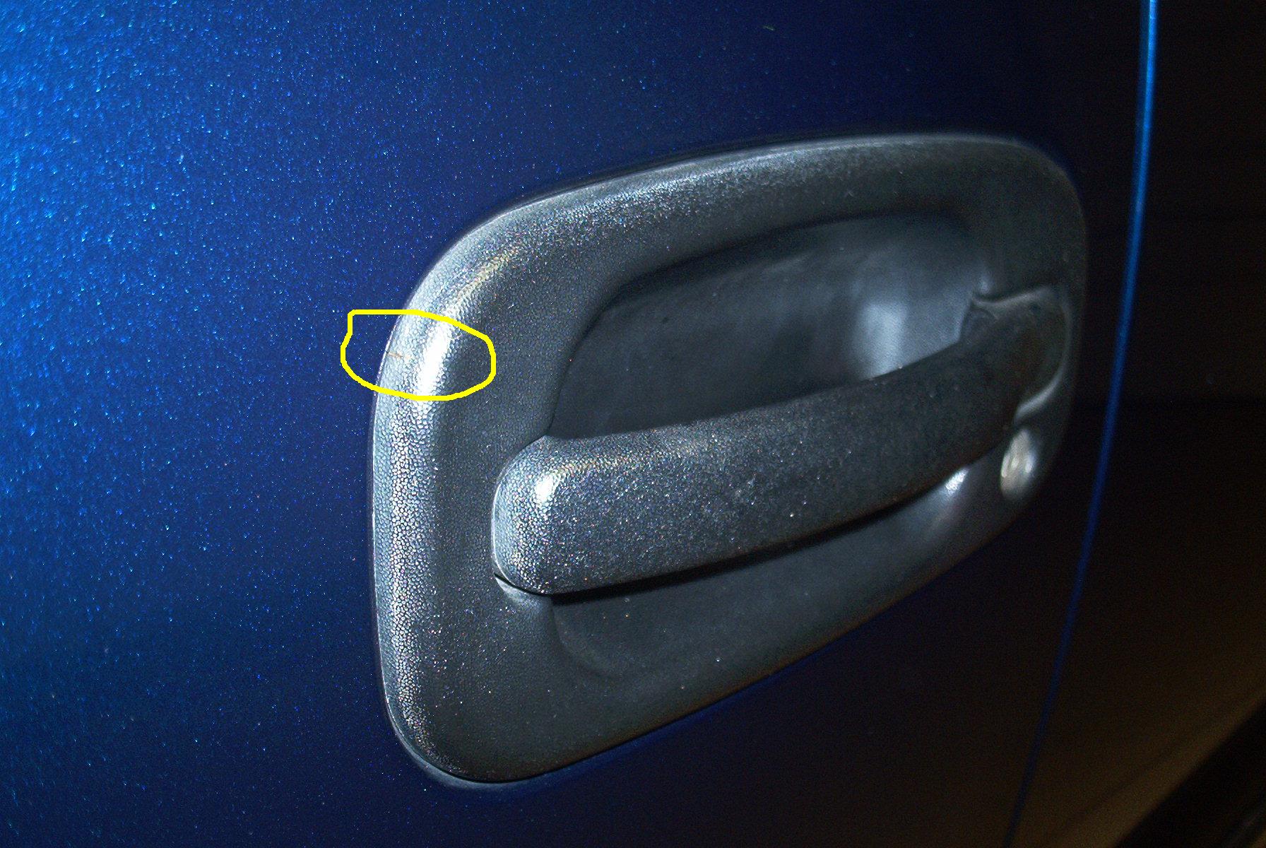

Noticed this today while washing my truck. Its on both sides same exact location. HMMM Anyone else have this happen? I have been thinking about new front speakers so it looks like I will put on some new handles while I am at it.

We haven't seen any of these style trucks door handles crack..yet! Yours is the first I've seen.
Now we saw a lot of the '88-'00 OBS trucks handles cracked alot.
Its not cracked through just like a tiny crack and on the drivers side what caught my eye or I probably wouldnt have seen it was it stuck out slightly and when I was washing my truck last night the towel snagged it. Checked the other side and the same exact thing in the same location. Its hardly noticable so when I get around to it I will replace.
