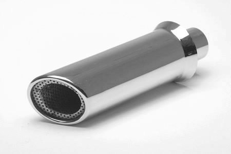

You really need an X-pipe or even an H-pipe which will help cut down the resonation your getting with those MF's. You also might try turning or rotating the mufflers on end a bit directing some of the resonation out instead of up into the cab. Also a resonated tip will help a bit as well. We can supply you a few like these that will help a bunch with your drone issues. Zoomers Cannon Tips $99.00 each
