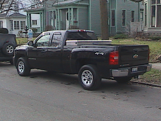

Here are some pics of my toolbox. Real simple to put on. It came with everything you need to attach it to the truck, no holes to drill. It has two L shaped clamps and four nuts and bolts. It also came with a soft foam to place between the truck bedrail and the toolbox itself.

That's a nice toolbox, how much does GM charge for one of those?

I got mine from the dealer for $399. They had it sitting around and couldn't get rid of it. GM sells it for $525. I really like it, strong and durable. The lid doesn't flex like cheaper boxes. I have stood on top of it many times without having to worry about it bending and it hasn't had an effect on my bed rails.
