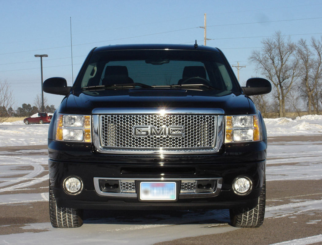

There is a member around here somewhere who painted his black. Maybe he will chime in soon.
That'd be Mod Crazy - he's around here somewhere. His truck looks niiiiiiice.

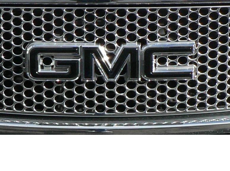

I blacked out my grille emblem within 4 hours of owning mine. I did mine with black vinyl from my sign shop (3M Gloss Black Scotchcal vinyl)! You could go to nearly any sign shop in your area and ask them for a piece of "scrap" large enough to cover the GMC and they'll probably give it to you if not REALLY cheap (I wouldn't give them more than $5 if they do want to charge...it's about $0.25 worth of product).
Then just clean it up good...peel the backing off the vinyl, rub it over the red plastic lettering...you'll then be able to see the edges of the GMC lettering quite clearly. Then take a good sharp Xacto knife, and gently slide it along the edges of the letters cutting away the excess black. Then take a credit card or similar and push the vinyl into the crevices (beveled edge of the plastic lettering) and you're done. Took me baout 20 minutes. I also did the small GMC on the tailgate...but them dumped it and put on the DENALI lettering like my doors.
Thanks for the pictures!
