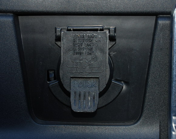

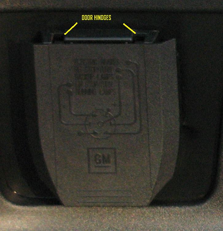

The door on the the left is for the trailer "plug". It opens easily with one finger from the bottom. If yours doesn't open there might not be a receptacle there.
I had the same problems with the wiring cover on mine too. I eventually twisted it and pulled enough that it came off. I think the trick is turning it. I would tell you but I don't have my truck available to mess around with it again and figure it out. But I'm pretty sure that it does come off.
I'd like to get a hitch for my '07 Silverado but I'm not sure of everything I need to know. I'll be pulling around a small 7'x5' trailer loaded with either a lawn tractor or firewood. So it won't be an incredible amount of weight.
I don't know if any of yall know what I'm talking about without a picture but on the back of the new Silverado's there's the license plate and then a little door on each side of it. The door to the right of the license plate opens to the left toward the plate and I'm pretty sure it's for cranking down the spare tire. The door to the left of the plate I can't get to open. I think it might be for a trailer to hook to but I'm not sure. There's definitely wires connecting to it underneath. Can someone tell me which way it opens? I've already cracked the darn thing trying to pry it open every which way with a screwdriver.
If yours doesn't have the tow package, it won't have the plug installed. You will have a blank cover there. I bought a plug from my boat dealer and it plugged right into the factory harness and snapped into the hole in the bumper... Looks like it came from the factory. Pollak was the name brand. I think I spent a bit under 20 bucks.
I'm sure you could get one online through Cabela's, Bass Pro Shops, etc. or any auto accessory outlet.

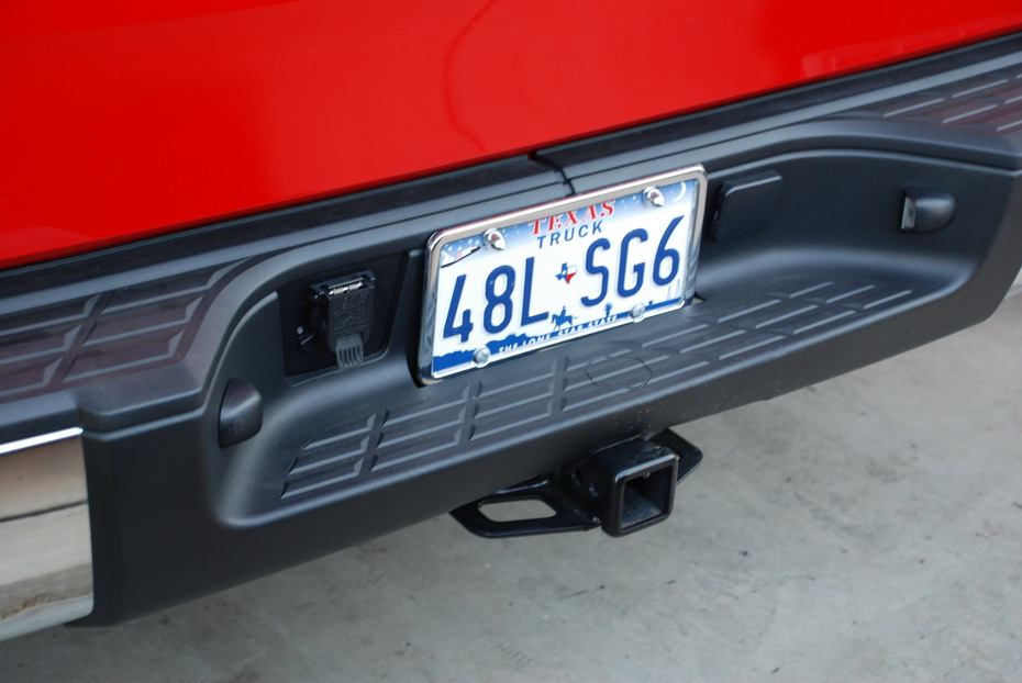

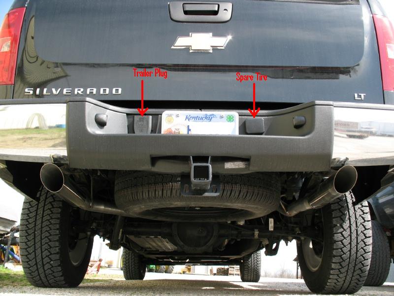

What's the spare tire thing in the attatched picture? My 2003 Silverado has something just like that on the rear bumper. I've always wondered what it was.
Check with you're Chevy dealer to see how much the Hitch Accessory PKG runs. I just had one installed on my 2007 NBS Silverado and it included a trailer plug that is shown on the left in KPZ71's picture. I got the Accessory PKG and they installed it all for around $230. The Accessory PKG itself was around $163 if you want to install it yourself. The hitch is a Class III hitch. That otta be good enough to pull a small trailer with riding lawnmower. I found this out @ GM-Trucks.com. :lol:
